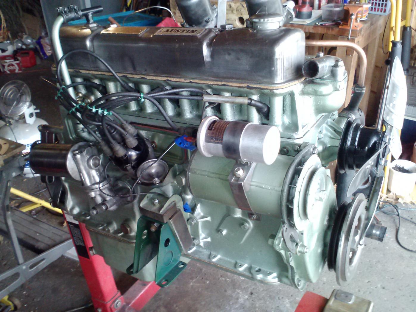

Reinstalling rebuilt engine tonight. Any hints on what should be left off and replaced after installation? Starter, fan blades , 1120130942a.jpgetc.

Where is the vacuum line to the dizzy????

Hi Susan,
I am less talented than the others here, and managed to bend both choke shafts on the carbs when removing my engine. I would humbly suggest removing the carbs before installing the engine. The choke shafts are difficult to find for the HD8's!!

Susan,
I noticed the position of the distributor - seems vacuum advance is usually pointing in the other direction.

Yep that dizzy is 180 degrees out .
