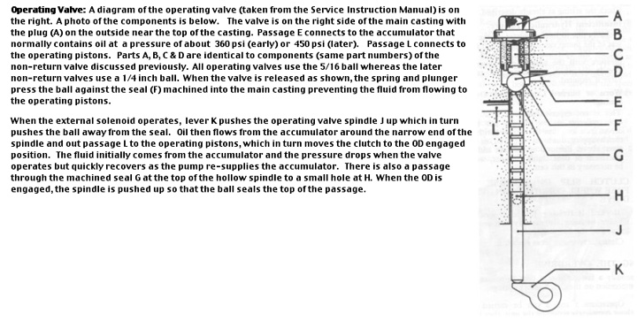

The operate valve - solenoid adjustment. How it works. See the attached pic.
Note that the operating valve ball "D" has to seal to the top of the small seat on the top of the spindle "G" when the OD is operated, (spindle "J" raised by the solenoid & levers).
Also the ball must seal on the housing "F" when the solenoid is NOT operated, to remove line pressure which enters the valve through port "E" & flows to the OD operating pistons through port "L".
The valve spindle "J" has a small bleed hole "H" which lets operate pressure in the OD operate pistons bleed off when the OD is not operated.
All of this to say - Tap the 5/16" ball into it's lower seat to improve the seal "F", lap the top of the spindle to the ball at seal "G". Replace with a new 5/16" ball, available at hardware stores & bearing supply stores.
Why?
If the solenoid is not lifting the spindle far enough, the OD will be slow to operate.
If the spindle is lifting too far, it may not seat at "F" when the solenoid is released, see below.
If seal "G" is leaking, the OD will not have full pressure.
If seal "F" is leaking, or the relief hole "H" is plugged, tiny hole, the OD will be held partially operated & reverse gear will not hold. Partial clutch movement, or failure to completely release will leave the OD clutch in a more or less neutral position & reverse may not hold. Forward direct drive is also supplemented by another one way mechanical clutch so it may not slip in forward even if the OD front clutch is not making full engagement.
If the solenoid arm adjustment is such that the ball valve tops out against it's spring before the top solenoid contact opens, the solenoid will likely burn out, unless it is separately fused.

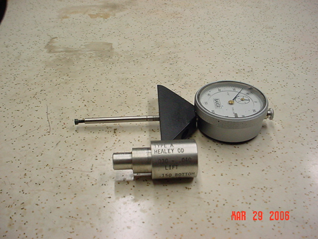

Make sure that the inside of the spindle & the tiny hole down on the side of spindle shank are not plugged.
It might require reforming the upper splndle seat & the lower ball seat to get it really right. A worn or scratched ball can also create a valve leak. It's not that hard to fix.
Stretching the spring about 1/8" or so, may help the seating, the springs usually collapse a bit with age.
You can see most of the parts here: https://www.mossmotors.com/Shop/ViewProducts.aspx?PlateIndexID=28884
Attached is a pic on the control valve ball lift gage that I made to set the operating arm.
D
