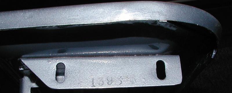

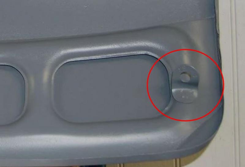

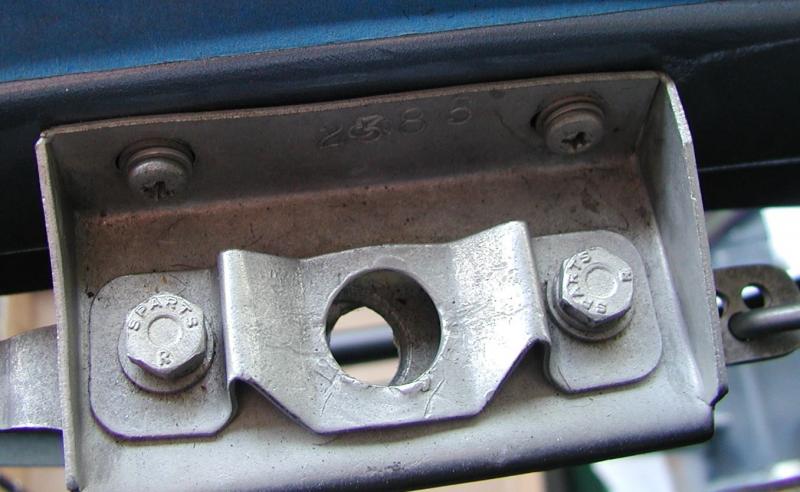

The body number or letter/number combination (Depending what model car you have) are located on the hood latch bracket, hood hinge bracket (LHD drivers side and may be hidden by the bracket/bolts) and the trunk prop bracket.
Hood Hinge Bracket
Hood Latch
Trunk Prop Bracket
