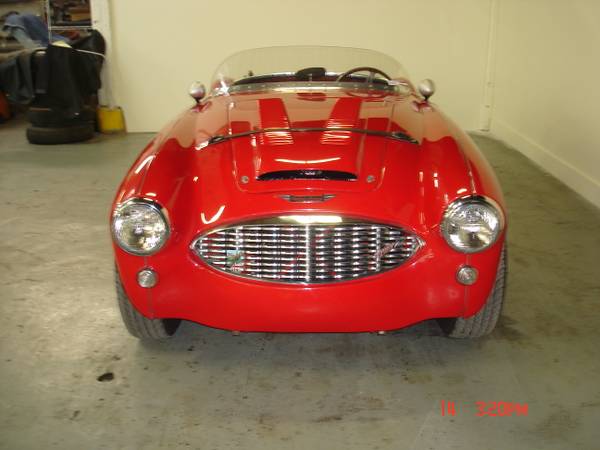

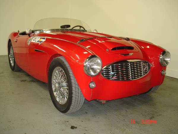

Here are some on a BN7 (from the net) , louvers done in a slight Vee look the best, But this looks cool because it belongs, my opinion is leave your car stock as it is pretty enough and like Rick said might just not look right on the BJ8 ... I agree

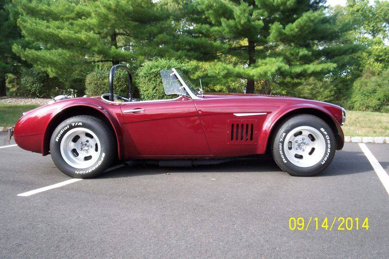

well I thought that I would update my thread. I sold the v8 bj7 and bought a v8 bn6....my preference of the two models. when I bought the bn6 it had outlandish fender flares front and rear with huge tires and wheels and lots of other unsightly things! I was able to find the aluminum fenders from another forum member and replaced the huge flared fenders with those. I am still contemplating rally vents...just because! and, I do appreciate the various points of view and the installation advice. I am driving the car regularly with no overheating problems...upgraded radiator, puller fan, and hood louvers help with that....but the rally vent look is compelling! thanks for all the help!

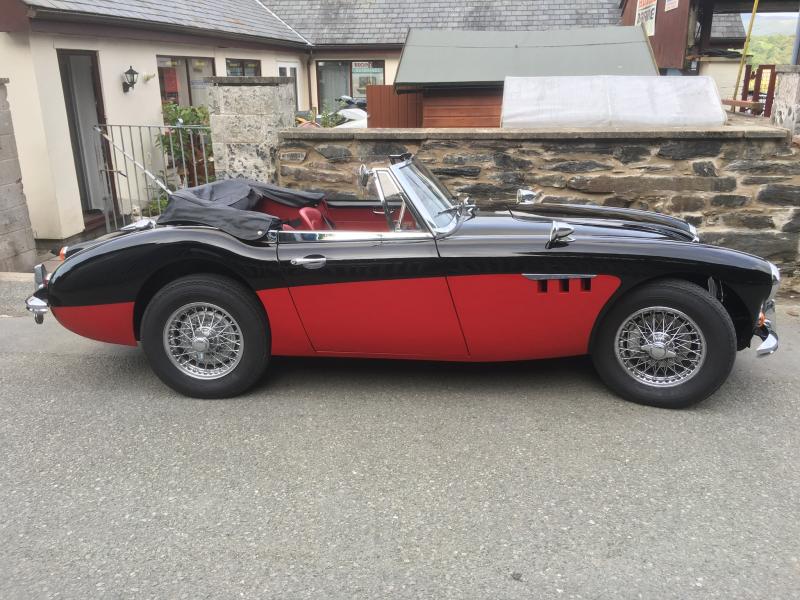

Side vents were added by previous owner after an upgraded manifold and exhaust was fitted, I did not like the look at first and was contemplating going back to standard however they do work well and although the rad has an aux electric fan it is never needed even following caravans up our steep mountain roads. 0DC1EB58-0C11-412A-B985-A9A690341919.jpg

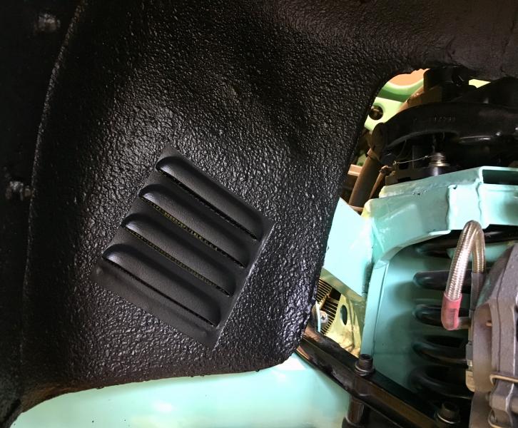

I've made these improvements on my vintage racer to help with cooling.

dougie
I really like the vents on the inner fender well ... very discrete. Do you think they help a lot; i.e. before/after comparisons?
This is a new addition I made while my race motor was out for a rebuild. I let you know after my first few races.
