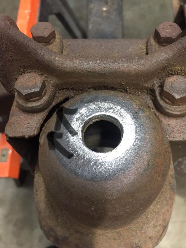

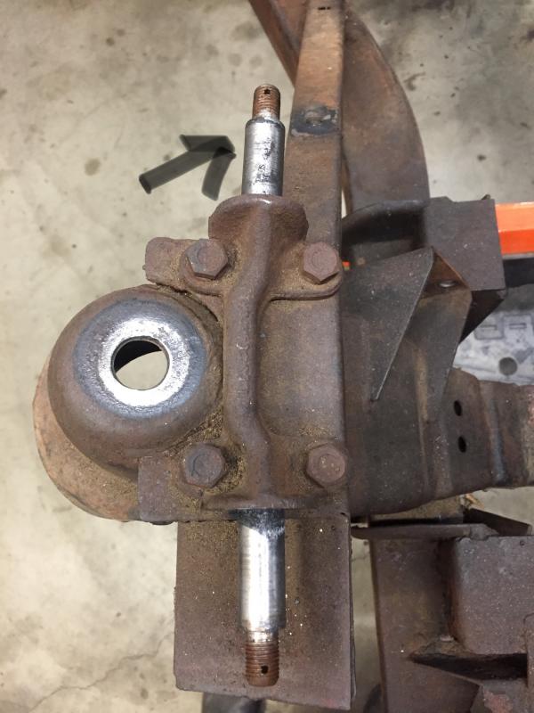

I finished stripping bare the TR6 frame yesterday and immediately noticed a problem at the right front corner. I am guessing this - the bent fulcrum pin and the torn away weld - is the result of an impact, unless this is a known weak spot and simply the result of age and hard driving. The body doesn’t look to have been crumpled at right front corner. Perhaps the right front wheel took a blow hard enough to do this. Any thoughts?
I would probably use some hydraulic assistance to tweak frame back into the ballpark. Right now that shock/spring tower is aiming a little low and inward as you look from front to rear.

I would start with a new fulcrum pin. See how it fits and proceed with your analysis.

You’re right, it definitely needs one of those, but the whole dang shock/spring tower is turned inward longitudinally (32 mm by the time the laser beam hits the trailing arm area) and the flat area that the top of the shock bolts to is tilting down a couple inches by the time the beam hits the garage door, compared to the driver side. The structure is also tilted in at the top three degrees - as in negative camber. It is as if that corner took a blow on a line from right front wheel hub towards the driver seat.
Have never had to tweak a frame, so I am flying blind but hoping a bottle jack pushing in the right place will do the trick. If not, maybe I need to look for a frame shop. Could find other issues with the frame too. The left rear and right front play teeter-totter across the other diagonal.
ps, that weld that broke loose didn’t look that sound to me, so I am wondering if other owners have seen anything similar.
