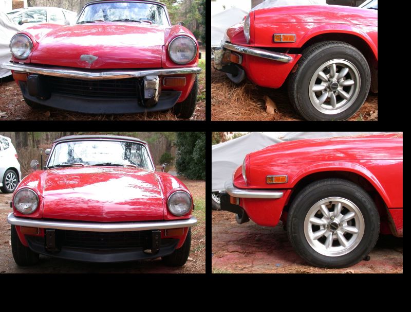

My son returns to college tomorrow and I have done what I could do quickly to get the Spitfire presentable until more complete repairs this summer. The picture below shows the before and after state of the car.
The original bumper was badly twisted and dented. The car now has the bumper from the parts car painted with Duplicolor Universal Chrome. It doesn't look chrome (looks like aluminum) but it is not rusty and painting allowed me to fill in the dents on the parts car bumper.
The frame horns pulled out OK and I painted them satin black since I do not have used overiders for the car. The satin black looks pretty good, leaving a normal appearance.
The bonnet dent has been pounded out but the bonnet has been hit before by previous owners. As such, the tip curls under a bit and wants to foul the bumper. I may fix that and repaint this bonnet... or I may fix the one on the parts car and swap bonnets this coming summer. Rattle can paint was used for the repair. It is not a perfect match but walking by the car you would not notice the mismatch.
Thanks again to all who offered help and support. The damage to my son's ego was a bigger issue and only time will repair that.

This was a rushed repair suitable for getting a driver back on the road and my son is very happy to have his car back.
Thank you all for your compliments.
