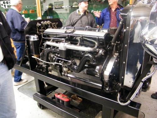

Bayless
How is this for an engine stand?
JPSmit
Nice - can I have the engine? I don't even care what it's for, it's shiny and I want it.
If I am not mistaken, early 30's Cadillac V-16....yes, V-16! Very impressive indeed.....!!
Hairyone
Cadillac V16 that'll be about 12.5 hp then
12.5 HP but 1250 ft/lb of torque!! LoL
