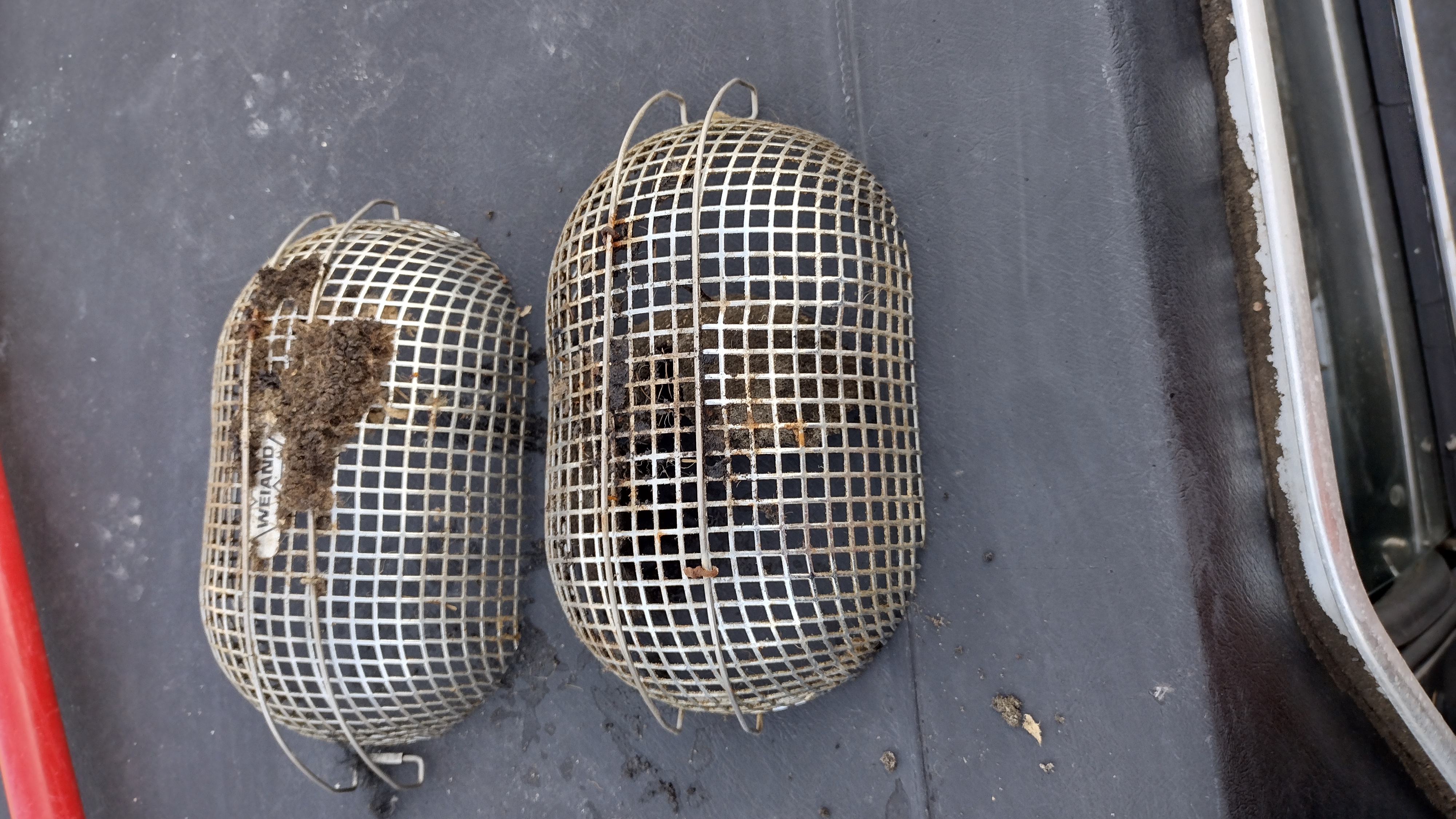

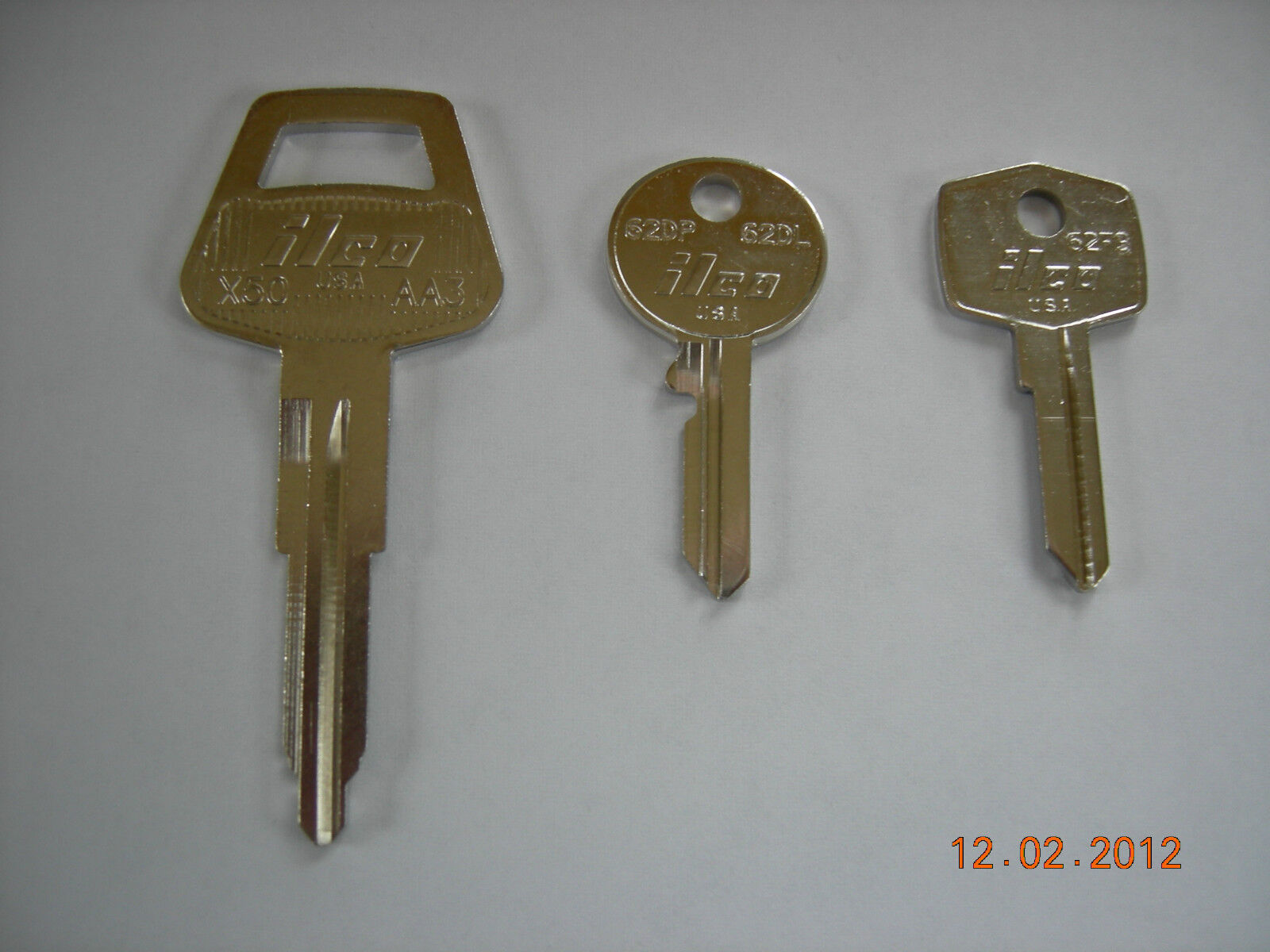

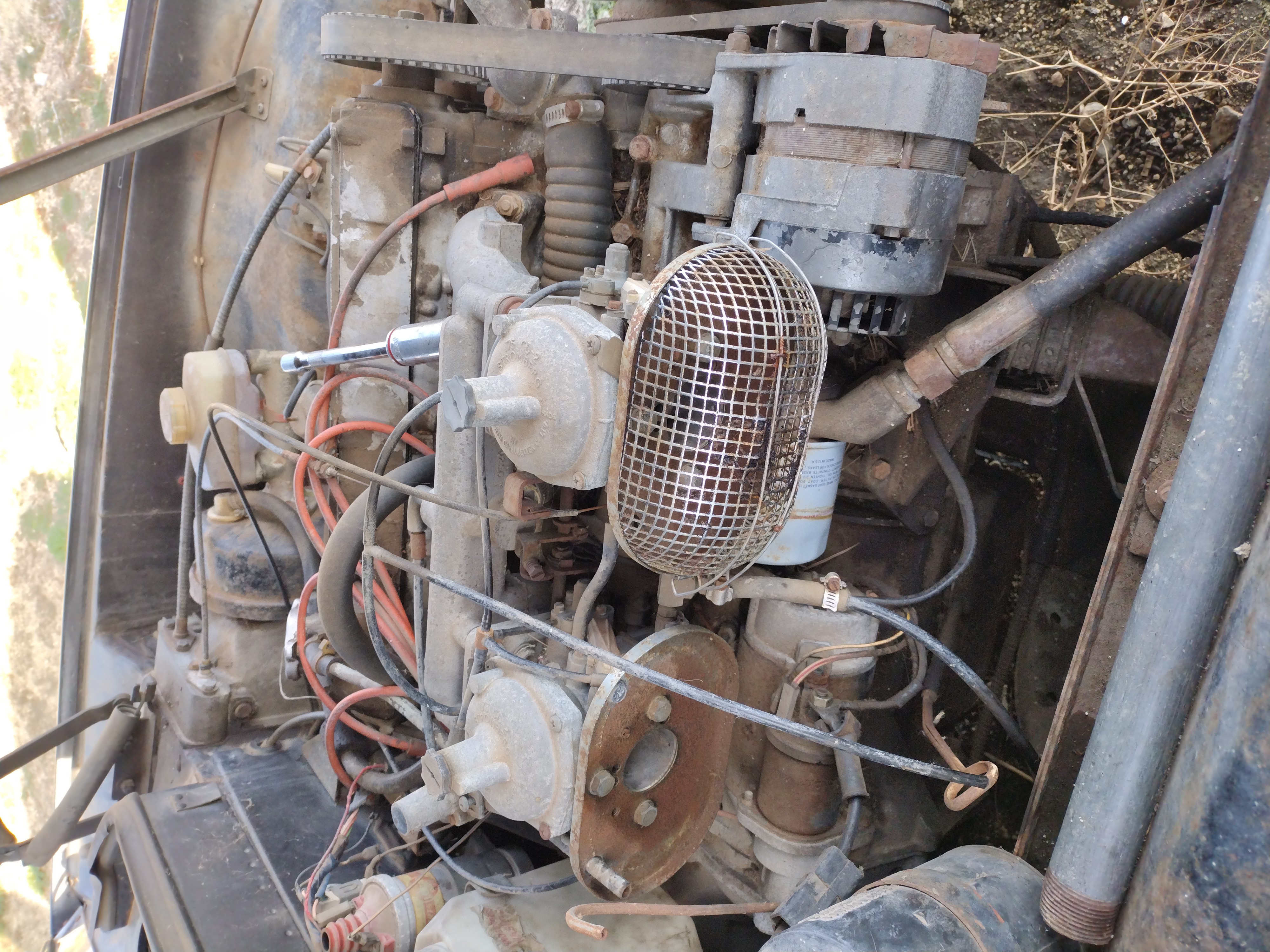

I have this 1974 Jensen i just picked up and I'm looking to start it. I need to know where to find the dual carbs air filter elements that go into the oval screens on the carbs.? So far no luck online. And also I have no keys..Is the Ignition the same as doors and Trunk same as glove box?

Those filters are an aftermarket item. Instead of trying to use them, bury them. They had a foam "filter" that would disintegrate and get sucked into the intakes. No need for air filtration until you know it runs anyway.
Does the engine turn by hand with plugs removed?
A bit of advice: before any attempt to spin it up, get info on setting it to TDC so you can replace that cam belt!

you can certainly run an aftermarket air filter - either a pancake filter
or K&N
you have the room

Thanks for info..Yes i took out plugs and soaked cylinders with PB blaster then with plugs still out Jumped starter and engine cranked good.
I already ordered cam belts
I'll order some aftermarket filters also

The ignition lock was a Leyland column lock, different key for door, trunk and glovebox.

This seems to indicate more than one key
So more than likely the ignition key is by itself..
I'll have to see if I can remove ignition cylinder..I jiggle the trunk lock open but ignition would open

A little googling suggests that you might <might> be able to get a number off the ignition cylinder - they're weren't a ton of choices of differetn keys and this outfit seems to be able to cut one from the number
