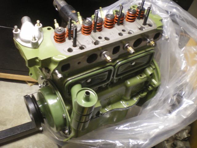

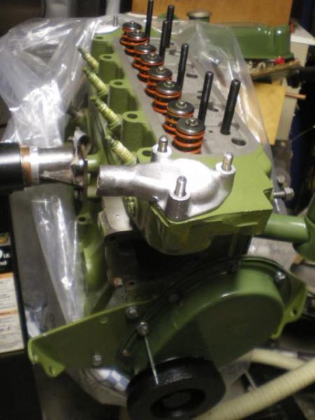

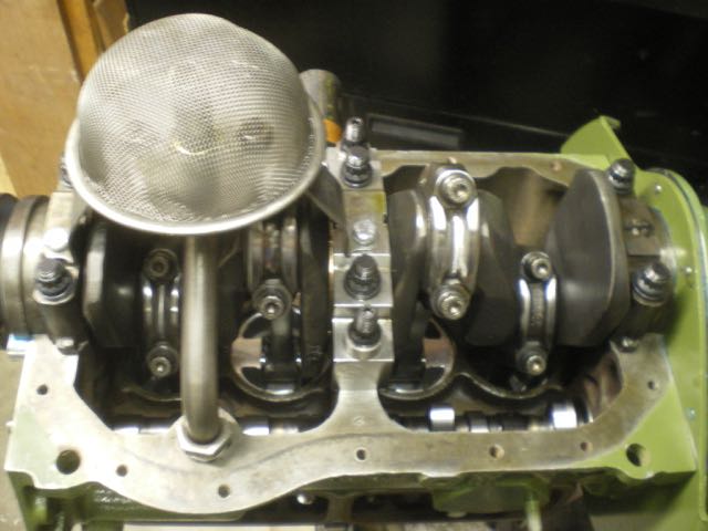

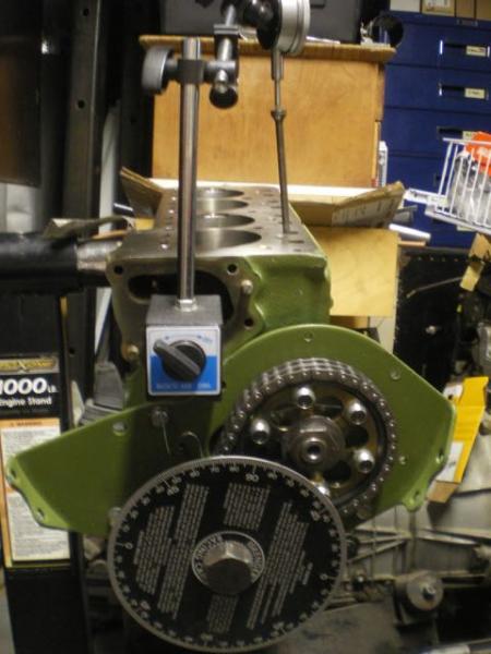

Here's a race engine I'm finishing this week. Crank, head, rods, cam, pistons, center main strap, lifters, oil pump, and all ARP fasteners, all supplied by APT

Thanks Mightymidget,
I wasn't suggesting you build a race engine, just posted pix so you could see APT parts I used.
There are several stages of ported head. Even the one I'm using on this engine is not a fill race head... nearly so, but not all the way. There are street versions that are less expensive and less aggressive. These engines are very restricted for breathing, and that's where you'll make the biggest gains.
Also, I forgot to mention, for your scenario, the vernier cam gear really isn't necessary. You do want to time the cam, but you'd be surprised how often modest cams come in right on the nose using a standard key in the crank. The worst case scenario is is that you might need to get an offset key, which are only $20-$30, instead of the ~$200 for the vernier cam gear. The cam in the engine I'm building is set for 102 degrees, whereas most stock and mild cams are 106. In your case, it'll be "set it and forget it".
