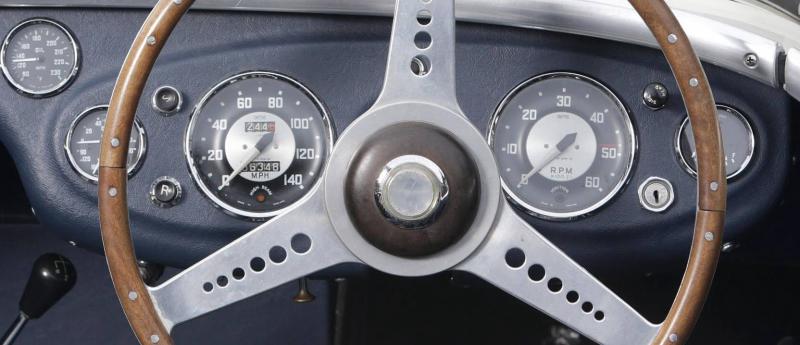

image.jpgThere is an R button on the left side of the dash. What is it for?

Seriously? I think it indicates a reserve tank?

View attachment 35679There is an R button on the left side of the dash. What is it for?
I know nothing about 100S's but I wonder why there is no windshield wiper switch and, if that is where it was originally located, whether the wipers were removed and the switch position given over to some other function. It looks to be a momentary switch.
Also, did 100S's originally have turn signals and if so where is the selector lever now located?

R is for reserve. The S has two fuel pumps. Each pump has its own tank inlet tube. One tube is a little bit higher than the other. If you run on the high tube's pump, switching to the low tube pump is like having a reserve gas supply.

100S's did not have turn signals. The front small lights are smaller than a 100. Also no windshield wipers as the plexiglass windscreen is only about 10 inches high. However a standard 100 windscreen could be fitted (see Mille Miglia pictures) and possibly the wipers also.
