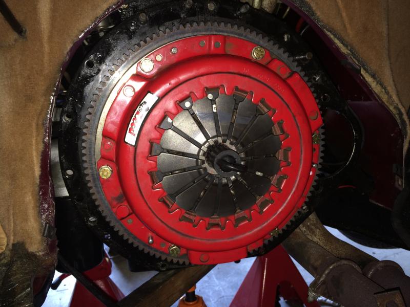

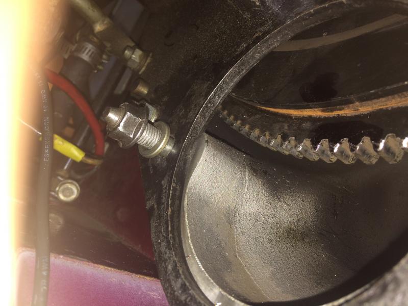

Now I know why my starter is not working.... It's not engaging the ring gear. See pic below, it looks like it moved back about 1/2".
Any ideas how to move it back without removing tranny?

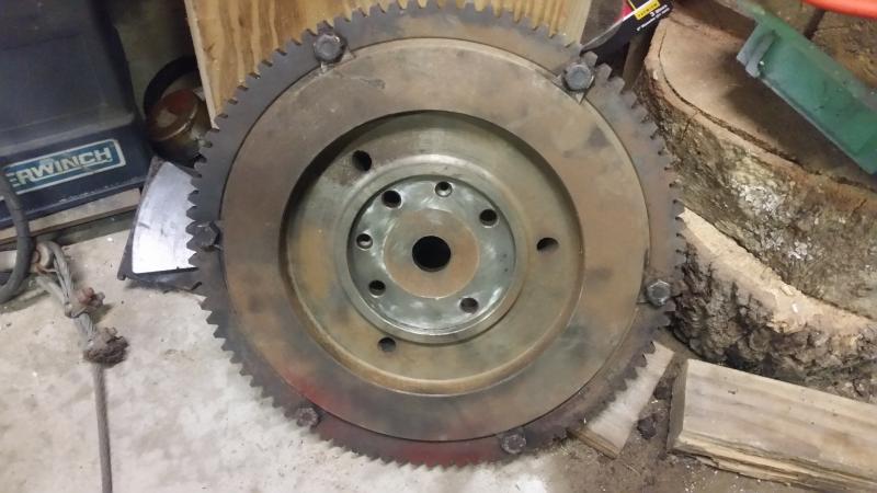

Is the TR6 flywheel different to the TR3?
The ring gear on my TR3 is bolted on to a flange on the flywheel.

Looking at the photo of your ring gear it looks like it is slightly angled. The new starter is a pr-engaged type so the starter gear would be pushed into the ring gear before the starter turns. Could have pushed it out of line?
This is a poor photo if Scotch/Dutch keying. The pins are often set screws.
The TR3 Flywheel is a little different. The ring gear is bolted up against a flange.

David- I have no doubt that's exactly what happened. The starter gear moved the ring gear back from smacking into it.

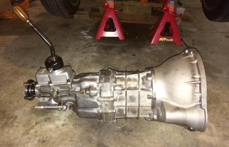

Made progress today.... Out it comes tomorrow if I can round up a crazy person to help in this 90+ degree temperatures.

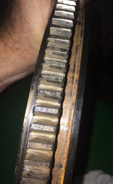

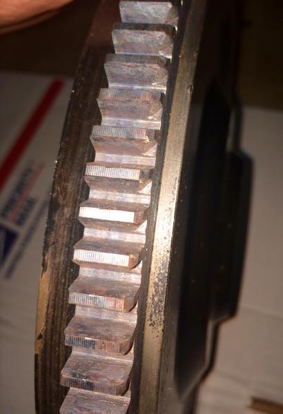

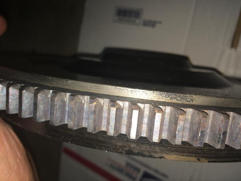

Finally got the flywheel off. Look how far the ring gear moved off of the shoulder. I'll be installing the a new ring gear sometime this week and then put it all back together (again!).
