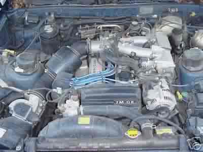

I have a 69 XKE 2+2 with no engine / trans in it. I have an 89 Toyota Supra engine & trans (80K mi.in the car). The 200 HP engine is a Duel overhead cam streight 6 with fuel injection and a 3L. I'm loosing 1.4L in size but it weighs a lot less.
Has anyone ever done this exchange?
Do you think that the car will perform good enough?
The gas milage should be a lot better and I think that the engine is more reliable.
Now is your chance to voice your opinion on distroying the orginality of a classic car.

Well......firstly, this is your car, and it is up to you what you do with it. Having said that, you can pick up a good OEM engine and transmission for the Jaguar for reasonable money, which will bolt right in, and will preserve the originality and thereby the value, if that is important to you. The Toyota unit will require some surgery, to what degree I don't know.
The XK engine is a reliable unit, provided the maintenance is kept up. Not the same as a Toyota, granted, but is this to be a daily driver or a weekend/nice weather car?

To some extent the "originality" is already compromised since the motor/trans are missing to begin with. So the real answer is whether to put some originality back or to make it a driver without any pretense of historical significance.
If you aren't into "the history thing" there's no emotional reason not to go with something like the Toyota. The choice would be primarily technical.
From that perspective there are few thoughts:
I can't say how 200 Japanese horses from 1989 compare to 265 British horses from 1969 but my guess is that you'll lose some performance (perhaps not a lot).
The Jag is a precisely balanced car. If the Toyota motor is significantly lighter there may be handling and front end "float" problems.
An E-Type's engine bay is not as simple as America cars of that era. It's likely to take considerable modification of either the motor or the car to make it fit. (Modifying the car instead of the motor really would be "destroying originality" while modifying the motor to just "drop in" would allow it to be undone later.)
It would probably take less time and money to acquire Jag pieces than to modify either the motor or the car.
An E-type has a market value. Should you decide to sell it you stand a good chance of selling it for something like others sell for.
A Jagota has no market value, zero. It would sell for whatever you could arrange with a buyer, no way of predicting what that may be.

Pc's observation that the Jag is balanced and there might be a problem created by a lighter motor is valid. When the E type was new (1960) the factory went through great efforts to certify that the new Jaguar could acheive exactly 150 MPH. In the trial runs that pursued, the gentelmen from Coventry discovered that the basic wing shape of the E type body had a tendency to float at high speeds on the front end. Very disconcerting for the prototype of a new era of high speed spo9rts cars. I would not think that the Toyota 6 would be able to push the 2+2 into the realm of 150 MPH so I wouldnt worry about that problem. On the positive side, your torsion bar front suspension can easily be adjusted to compensate for the lighter load on the front.

Another point to consider: The Toyota engine in question (a 7MGE according to the picture) is notorious for head gasket problems (or so I'm told by Toyota experts)

Aside from the originality, value, etc. issues there is another one to consider and that is a safety issue. The E-type is of monocoque construction, essentially the front frame rails which support the engine and suspension is bolted to the body tub. These rails are made of a particularly strong Reynolds steel which cannot be merely cut and then rewelded. There is a process that must be adhered to if that is done. That being said if the engine doesn't fit without a need to modify the frame rails don't do it as you might find yourself going down the road with only half of a car.
