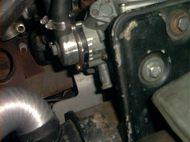

The antifreeze should not have an effect on the choke. The coolant running through the housing only warms up a temperature sensitive spring and makes that spring wind/unwind according to the temperature of the coolant running through the housing. Now, if you took the water housing off to check the choke, and did not get the choke pin connected to the spring properly then the car could run fully choked all the time or no choke all the time, because the spring would not be moving the choke pin and the pin would tend to stay in whatever position it was when the housing was taken off. It could also be due to improper alignment of the water housing as the spring is connected to the housing. Here is the pic of my carb showing the choke body, water housing and the alignment marks. The marks are kind of hard to see, but they are raised metal lines on the water housing and the choke body. These should line up. lc - you said that you checked the choke according to one of the previously mentioned web sites, did you make sure that the choke pin fit back into the rectangular portion of the spring?

here's a better pic of the markings. please note that your hoses are at 6 o'clock and 10 o'clock in your picture while mine are 11 o'clock and 1 o'clock, so a different cover?
Paul bunyan's pics show the hoses at 12 and 8.
Boy am i confused!
Now is that cap that the hoses are connected to supposed to be loose or permanently fixed. Mine will move with no resistance.
By the way, here's a better pic of the markings. The white mark on the hose cap is proment here.

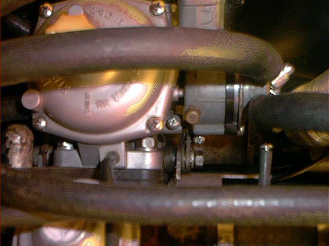

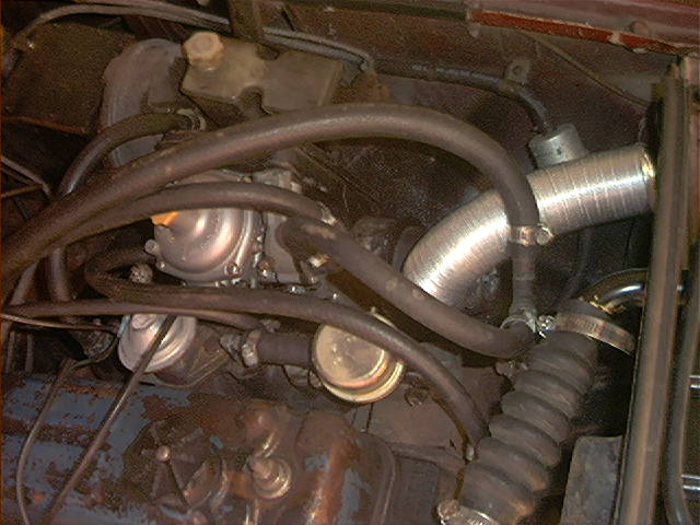

here's the overall engine layout that shows the "smog" equip missing. A couple of pics sent seperately. Do these pic's help?

Is there a metal line on the choke body more towards the engine? In a similar place as shown in the photo I posted? This alignment mark should go all the way across the choke body.
The water housing should be fixed tight. It should not be loose. perhaps a pic of the top of the carb would be usefull as I do not trust the little white marks from the PO.

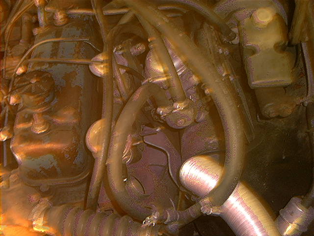

Okay, the pic from the top shows the alignment mark on the choke body
Look at this pic:
This shows my carb from the top. Starting at the choke body you can see the long raised alignment line. Next is the black plastic spacer, this also has a small alignment mark. Next is the Spring body, the part that holds the spring and is attached to the water housing by the bolt on the side of the water housing. Then there's the metal ring with the three screws that holds the whole assembly to the carb (not labeled in the pic). This too will show an alignment mark, and then there is the water housing. The important part is to get the marks on the choke body and the spring body to line up. You can't see the mark on the spring body in my pic, but it is there. If you need to rotate the spring body, loosen the bolt on the side of the water housing and you should be able to rotate the spring body so that you can still have the hoses in a good position. Let me know if this makes sense...
Mine is the same as in pauls photo, only my spring body is rotated differently. It's the alignment marks that are important.

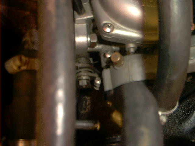

here's another pic from the top with the marks.
it looks like yours (and everybody else's water cap is different from mine because of the hose coupling. a previous owner may have married different parts.
I can't get my hoses 90 degrees to the left. think i need a replacement housing? if so where?

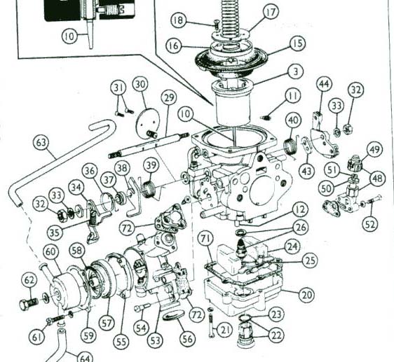

yup, the #55 part is the black plastic spacer. 18.95 from Moss. A tad expensive for a plastic piece, but you don't have to get the rebuild kit, yo can just order this part. If the pin was not engaged with the spring then that was definately a problem, and might be THE problem. Were you able to rotate the spring body so that that the alignment marks will line up?
