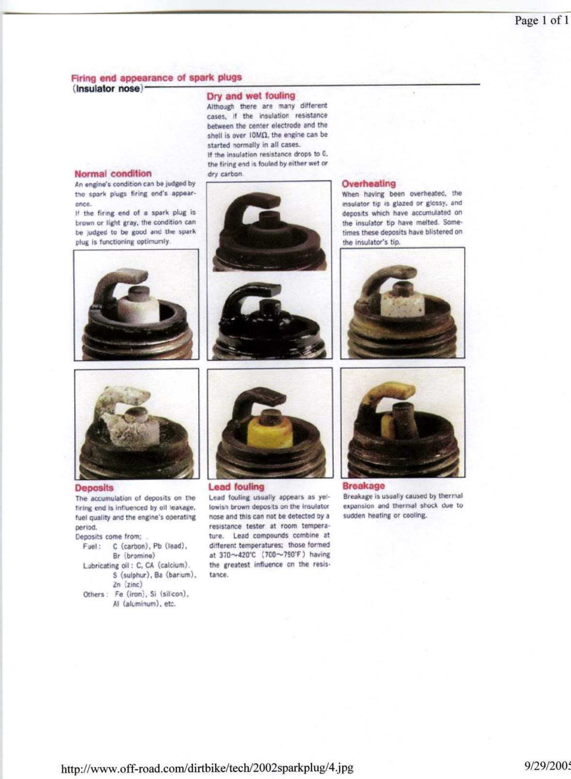

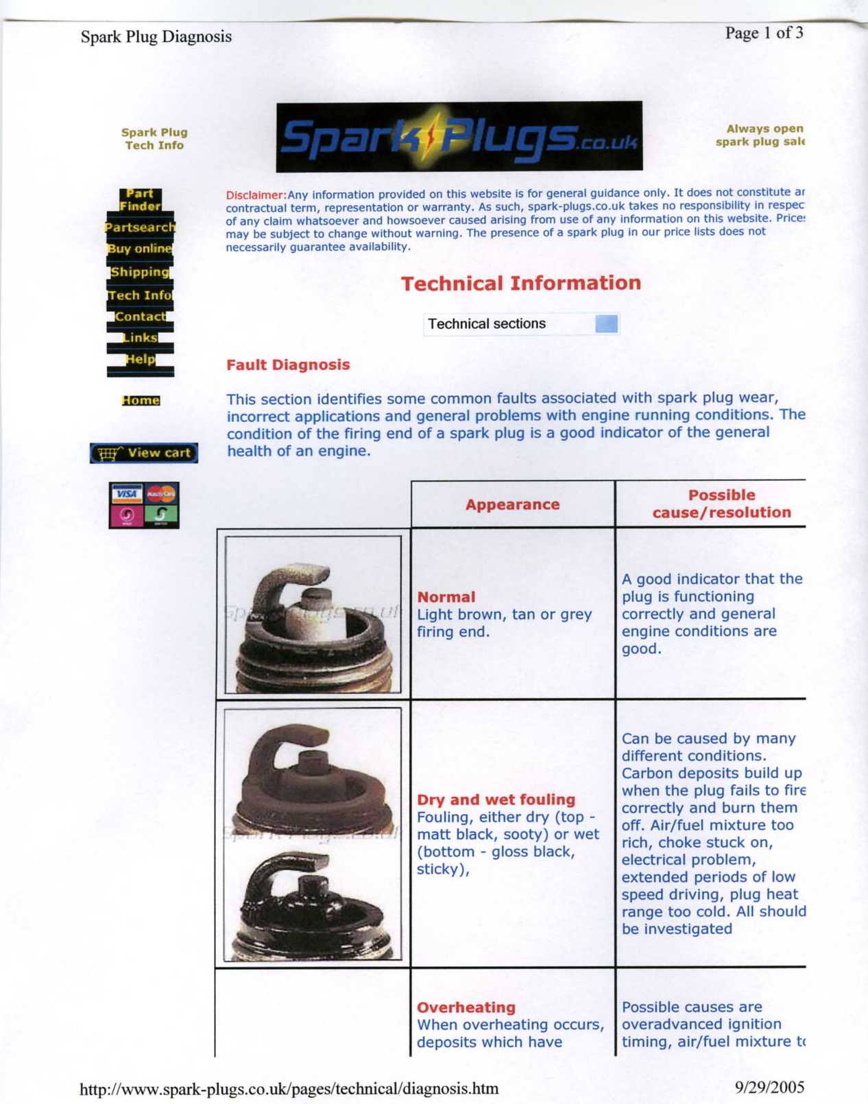

that pic wasn't so good, so i did some research. The center pic in this attrachment is like my problem.
here's another file showing the same problem in the 3rd pic.

i put 4 new plugs in, drove about 5 miles tops and the tips were black and seemed wet.
if you look at the pics i posted yesterday that what the old ones looked like before being replaced. all were wet.

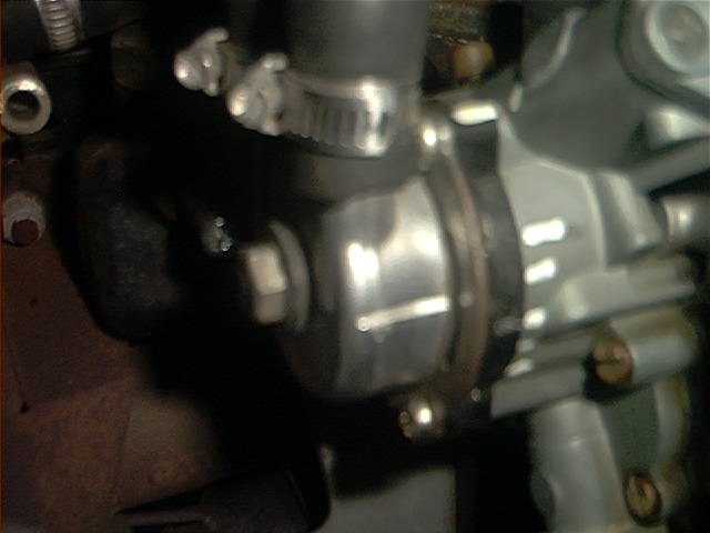

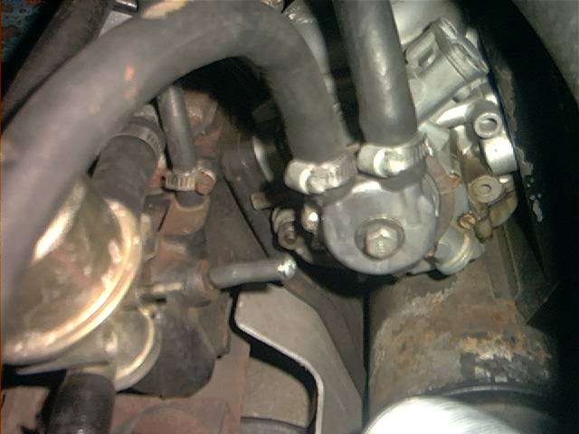

Now, getting into that water choke . . . just how should this operate? There are two hoses connected to a housing. The housing is loose, allowing the thing to move in about a 90 degree arc. I presume this is normal for this to move. on the housing, someone painted white lines presumabily for different positions. I can shoot a pic of this if someone thinks it would help.

lc - looks to me from your pics (the first blurry one) that your choke needs to rotate about 90 degrees toward the engine. This is assuming that the white line on the housing with the hoses (choke temperature housing) is the original locating line. It should be a raised metal line on the housing. This should line up with the mark on the choke body of the carb which is hard to see, but is at the top of the carb. It looks like someone replaced the original housing, as I've not seen a housing configuration like that on a stromberg. Given that someone has marked different spots on the choke body, I would suspect that this is your problem, and with the choke temp housing rotated away from the engine the car will remain choked even when warmed up. I'll see if I can bet a good pic of my carb tomorrow.
I also noticed tonight that my car does blow whitish smoke till warmed up and blows carbon out of the tail pipe (rich from the choke). Once the choke is off (car warmed up) the smoke goes away for the most part and no more carbon.
Also, see if you can take a pic or two of the engine showing the emissions routing (what's left). It looks like the previous owner was trying to compensated for some other problem (lean condition) by adjusting your choke. You shouldn't have to do this (nor would you want too). I suspect that when some of the emissions came off they didn't re-route something correctly. Same thing happened with my car. It's not too hard to get sorted though.
