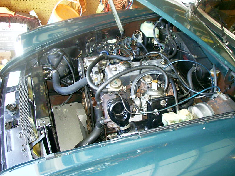

Here's a pic of my 78's engine bay.
No lines over the heater box. Could this be one of those "varibles" often talked about from the production line?

Hey Tony, Just noticed on Bret's photo, the brahe booster line and airpump line are run the same as on mine (RE: carboard thingy) maybe this was another late production line variable?
Cheers Ric
Guys, look up under the lip of the body - they run behind the hood hinges.
Nice clean engine room, I'm impressed.
Hi Tony, have wandered out and re-checked, no hyd lines over heater, they are run along lip below and in front of heater, my vac/air pump lines are the same as Brets. Glad that I don't want a show car. But still very interesting the number of variations, and how some are the same as others.

Okay, first off, the ONLY reason Binabox's engine bay is clean is because she's not been driven. Give me a few months! Here's Emma's, when I was changing the water pump. She's DIRTY!
& Emma's brake lines run OVER the heater! I can see them in the photo.

Brett - if they aren't up there, they've been changed by a PO because that wasn't one of the variances - you've got power assisted brakes...they come out the MC & follow the fender until they cross over the heater (up behind the lip of the body behind the hinges) just like in Kenny's photo.
