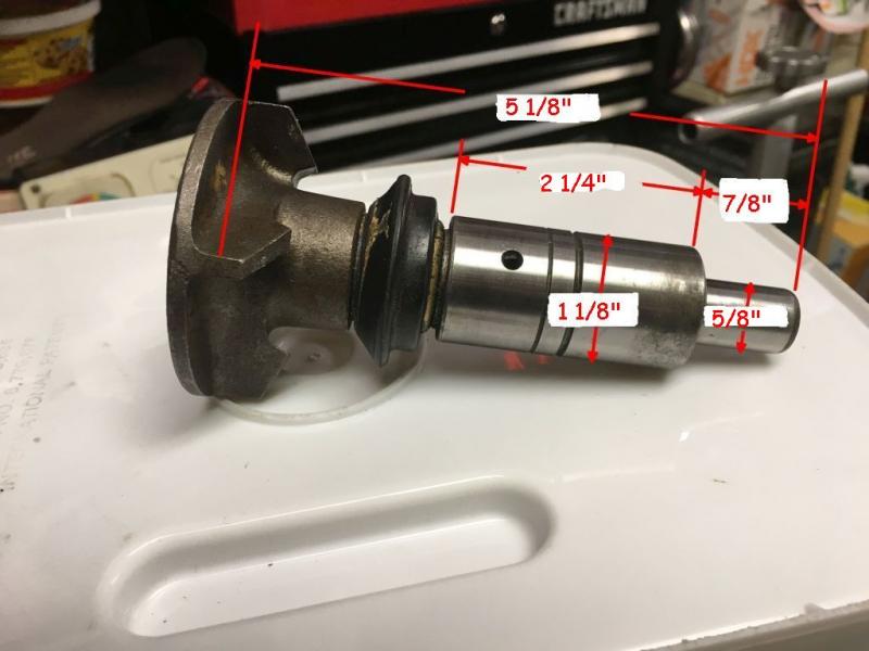

I pulled mine apart and sent the following measurements to Mike Salter. He said it was rebuildable and I did. It's now my spare.
On the original BJ8 pump there is an emblem in the shape of a diamond with some indistinguishable lettering inside. It is visible on Mikes video. I rebuilt mine along with John via phone conversations. Problem is I don't know if I did well until I need it as it rides in my boot.
