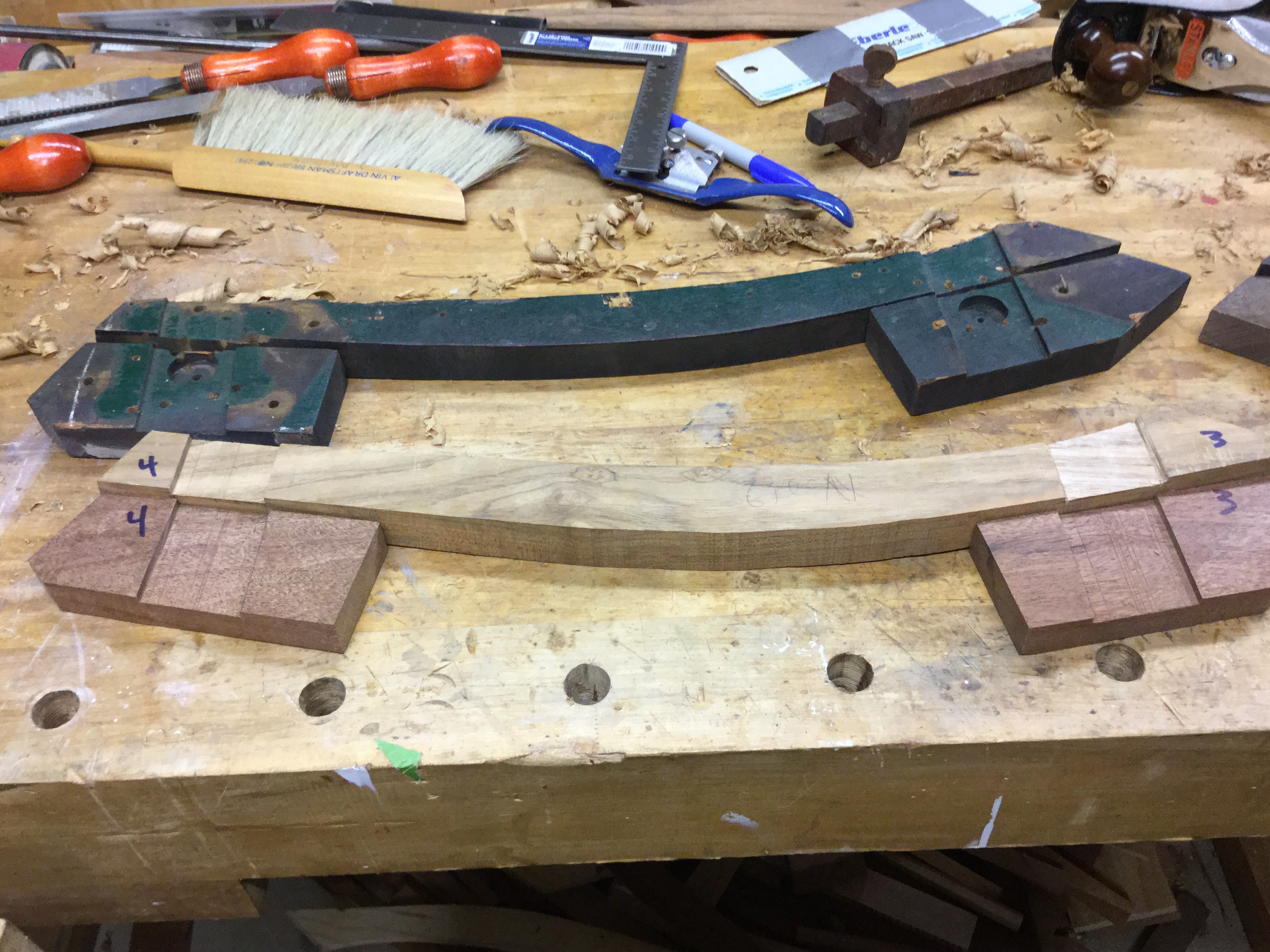

Hey Jim did your 1959 tr3 have wood under the dash for fasteners and wood on the door top also.
steve
Yes on the doors which I replaced, and no under the dash, which I looked for.
Replaced the ash that is (my other hobby is woodworking)

Charley, I did one side on mine and would be interested in your upgrade. Perhaps I'll do the other side some day.
Tom
Jim,
Have you installed the wooden parts in the door yet?
If not, I did an upgrade when I made mine. I will explain if you are interested.
Charley
Oh yes long ago, but thanks anyways!
The upgrade I speak of has to do with the tonneau cover studs located on the side of the doors. I placed a small metal plate below each stud. You would need to remove a small amount of wood and then attach the metal plates with small screws. Then when you mount the studs you drill a hole using the hole in the door as your guide. This allows you to screw the stud into metal instead of wood.
This could work to "repair "an existing set of wood inserts.
