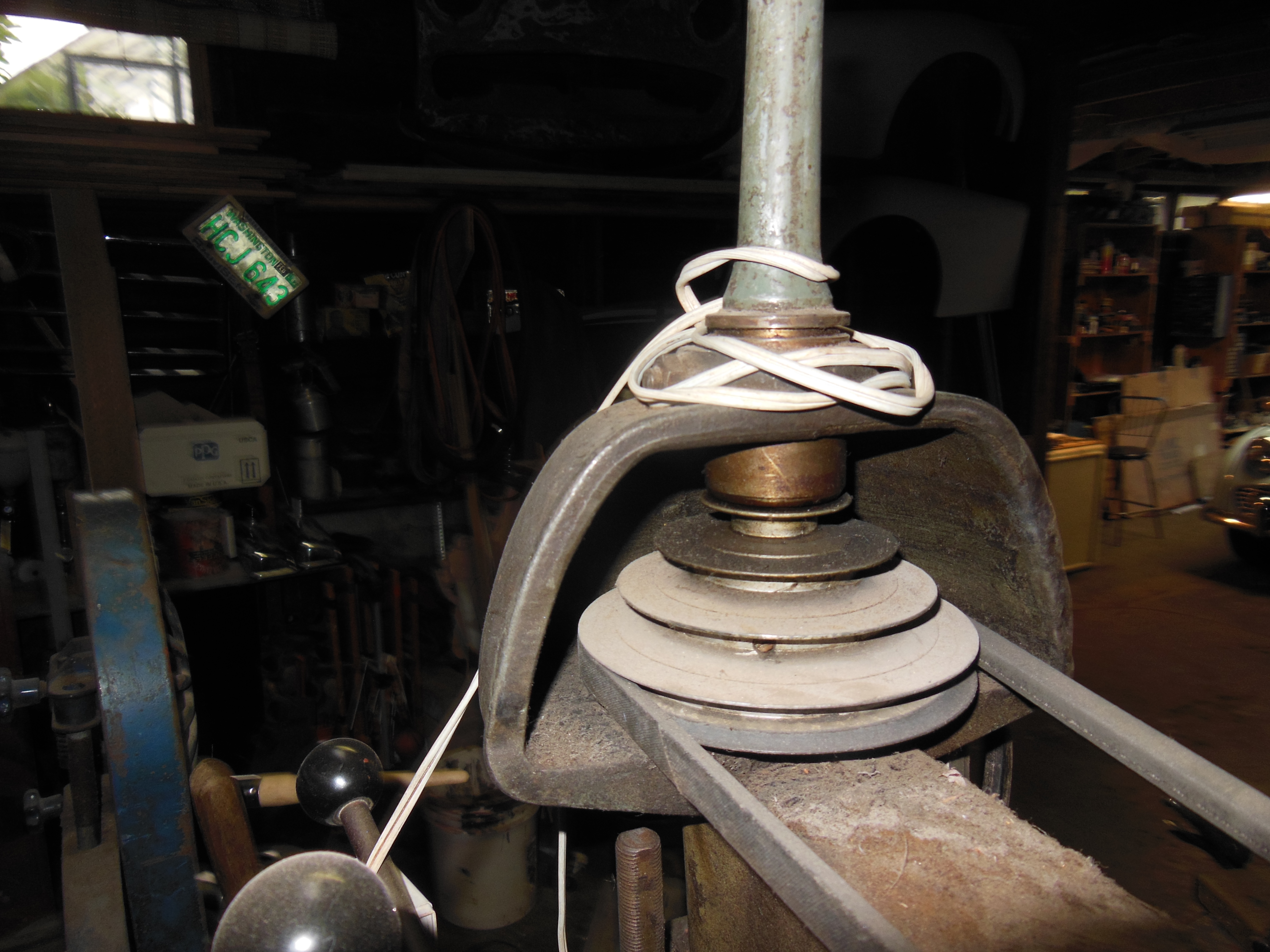

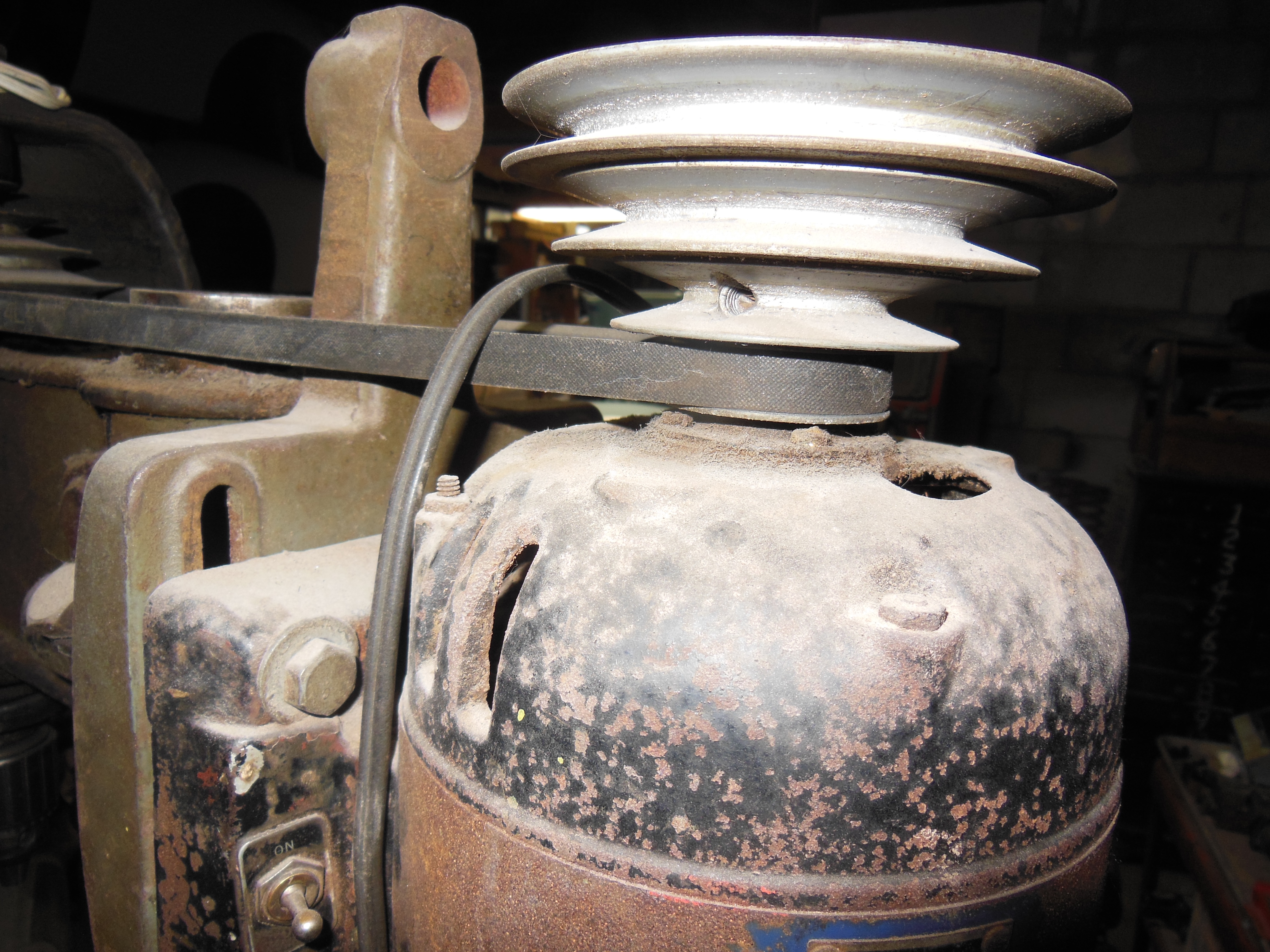

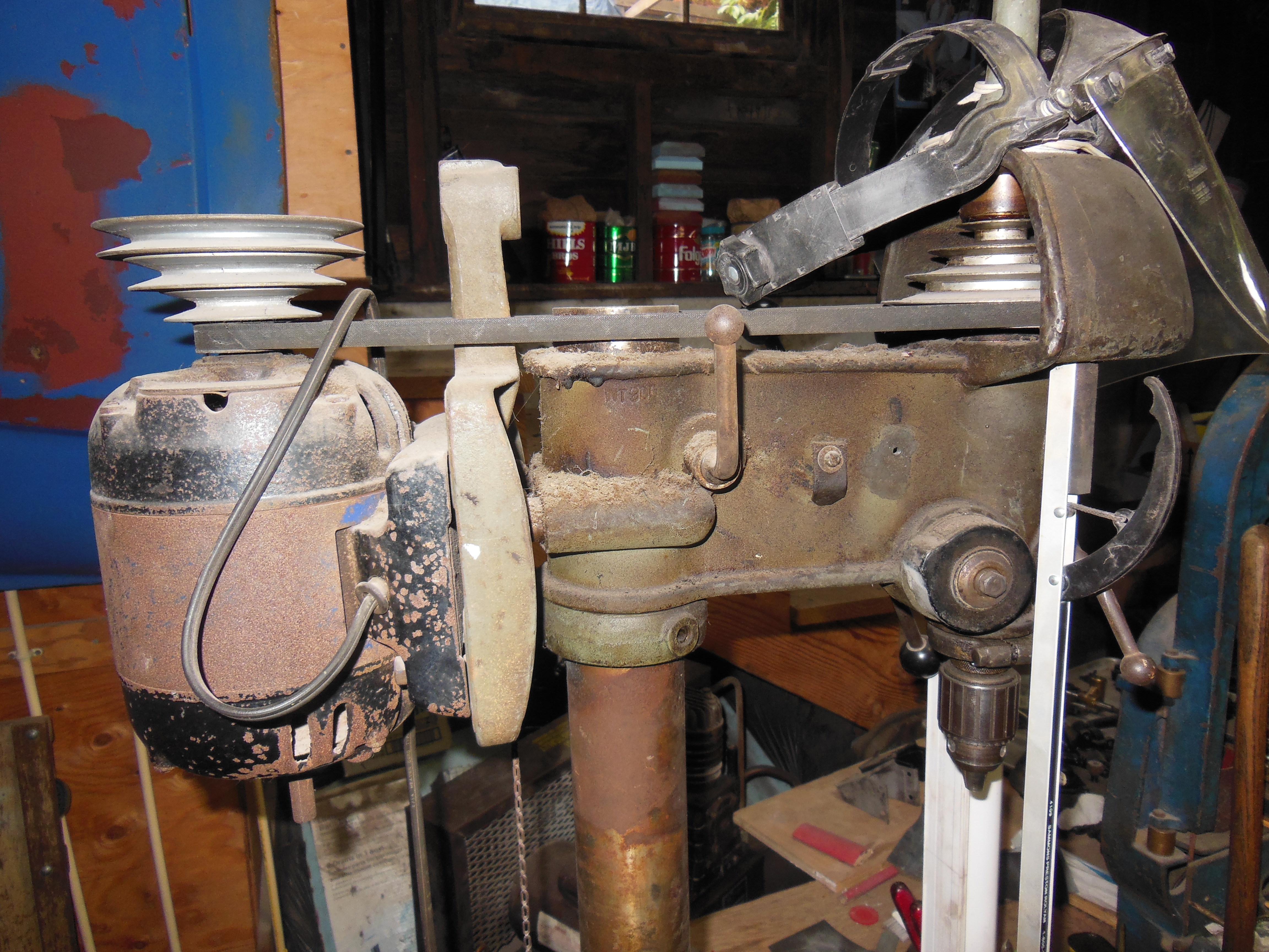

I have an old drill press that has belts to change the speed of rotation. What I want to do check some vertical links for their trueness by spinning them in the drill press. My problem is I do not know what speed to spin them and how to move the belt up or down to get the speed correct. I see some set screws on the pulleys and changing the speed could be very simple. It looks the set screw on the motor end will come loose and lift right off. Anyone have experience with these old drill press.

Though you apparently do not need to change your drill press speed. You do not alter the pulleys. You only move the belt either up or down depending on the speed you want. Keep the belt level. It presently set up for slow speed. Small pulley on motor to large pulley on drill.

Thanks guys, hey Charlie does a guy need to remove the pulleys to change the speed, or can you somehow move the belt with everything in place. If so, it looks like the end without the motor might be the one to move. It has an oiling hole and seems like it needs tending too for maintenance.

That lever on the side of the press should loosen the belts enough to do whatever you need to do with them. Then re-tighten the lever when done.
