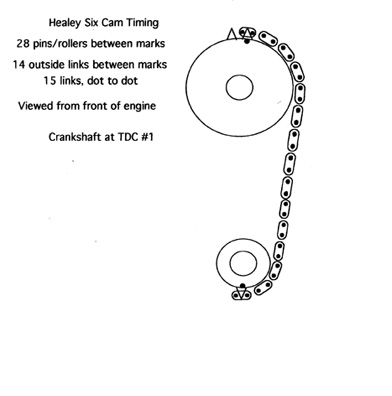

Sarge,
If you have 15 links between dots, this means that there are 32 rollers between the marked teeth. I think that you are two links off. There should be 13 complete links between dotted teeth plus 1/2 link or one roller on each end, or 28 rollers. Also I think you need to rotate the cam gear half a turn. I think the attached sketch is what you want.
If I have this screwed up, someone will say so in a hurry.
D

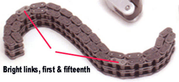

I attached a pic of a DW chain that has the first & fifteenth links marked.
D

Well I've done it! I removed the timing gear and chain and repositioned the timing gear 180 degrees so the DOT is at 12 o'clock, and the DOT on the crank is at 6 o'clock and there is 15 links DOT to DOT With #1 at TDC. Gaskets arrived today and the radiator will be in tomorrow so should have it running Monday. There were no shinney links on my chain. Thanks for your help everyone.
