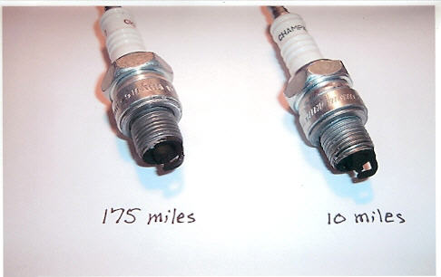

How about some pictures showing us the plugs?
Scott
Scott,
Here are two Champion spark plugs. I put the first in new and drove 175 miles, took it out, and this is what I found. I then put another new Champion and drove about 15 miles, took it out, and found the same thing. Whether they are sooty or carbon fouled, they don't look like the other three spark plugs (#s 2, 3, 4) which are textbook normal.
This is what has bothered me.

For what it's worth I was having problems with all four plugs carbon fouling on my TR3. I switched to NGKs and the problem disappeared. Personally I don't think the Champions are as of good quality as they used to be. You could try opening the spark plug gap on that plug to .028 and see what happens.

Sooty plugs are caused by only 2 conditions. It,s a rich carburetor...which you can rule out since the #2 hole is good. Or...ignition. You are loosing spark to that hole. Even brand new wires and plugs can be defective. Check cap, wire, and plug. On a long shot, if those don't help, look at the distributor point lobe to make sure one is not flat.
Remove the distributor cap and connect the #1 plug to the wire boot (out of the engine). You can then check the resistance from the contact in the cap through to the electrode on the plug. If it seems high, do the same for another wire to compare. While checking this, wiggle the wire in the cap and plug boot to see if you have an intermittent contact.
If all seems good, swap the plug with a good one from a good hole. It could be an internal short in the plug.
It,s good you will be checking the compression, to be sure...but your problem lies in the spark!

SUCCESS... at last. And the cure is as mysterious as the problem was.
Here's what has happened.
The car went in for a Spring Tune-up about ten days ago. The mechanics adjusted the valves, put in new points,new distributor cap, new plugs .... and worked on the fuel mixture.
When I got home, I check the plugs -- to put anti-seize on them -- and found that #1 plug was "sooty" or "carbon fouled." All the other plugs were fine.
I checked the #1 lead wire, distributor cap connection, and two or three other possibilities. I put in a new plug, drove 175 miles, and that plug was sooty. I put in another new plug, and it, too, soon became sooty.
Then a week bending the ear of Forum folks with this problem.
In the meanwhile, I studied up on how to balance my carbs and adjust the mixture. I know it sounds easy, but not for a novice like me. I even wrote up a step-by-step manual on how to do it. Got help from the Forum. Thanks.
Today, I worked on the carbs. They were completely out of balance. I balanced them as well as I could with a Unisyn (I couldn't get the little wires in the SU kit to work). Then I adjusted the mixture and carefully adjusted the idle. I then pulled the #1 plug, and cleaned it off, and put it back in. After all that, I hit the road.
Car ran very well. When I returned home, I pulled the #1 plug and it was NORMAL. No carbon fouling or soot.
Don't know why it worked.... but it did!
