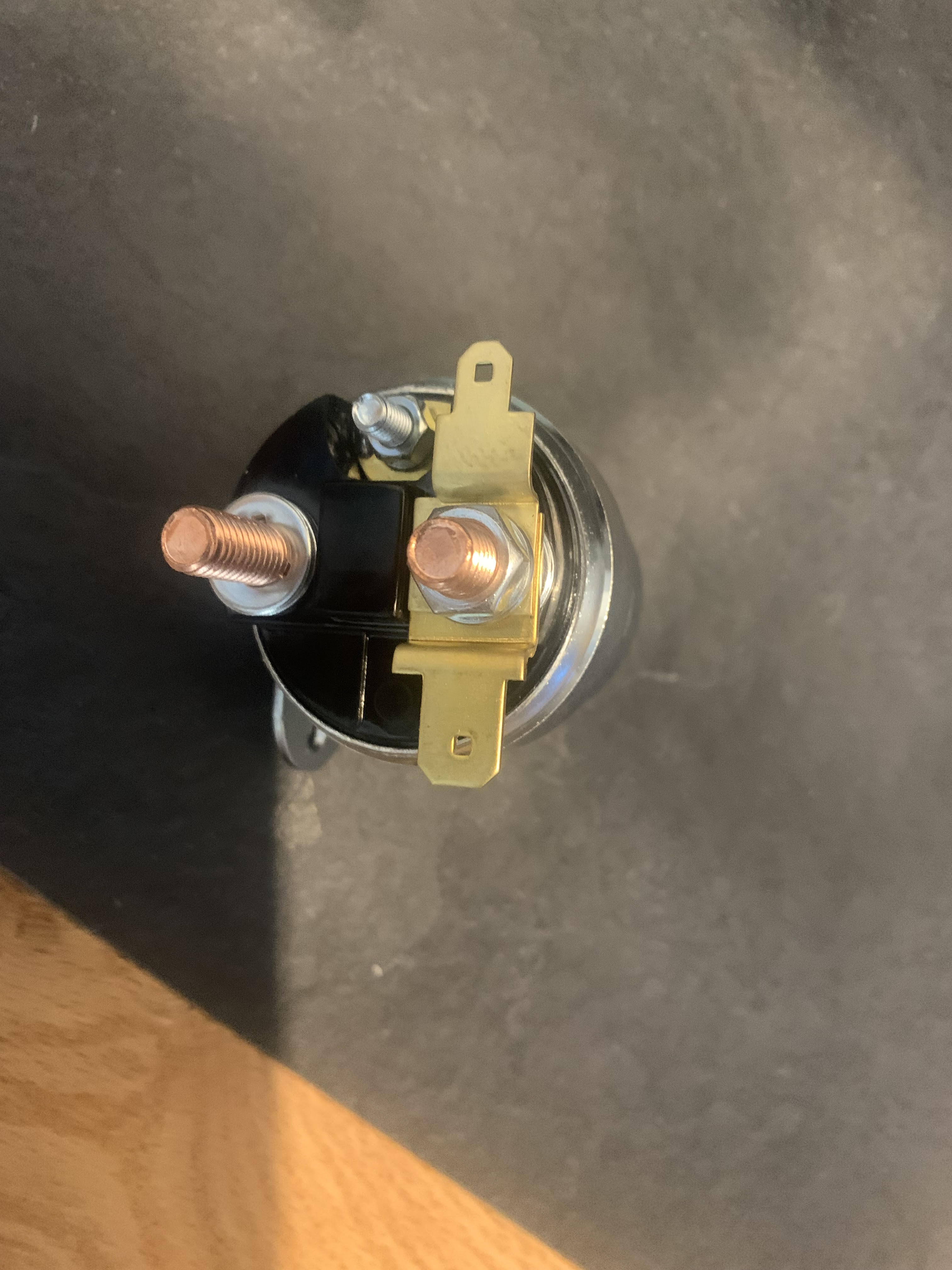

I did buy a new Solenoid - from Moss Motors - not sure about the small red wire and white wire - which contact to attached to on Solenoid- how do I attached a photo of Solenoid to show?
Well, it sounds like your wires have faded...or been changed. The large contact without the tabs goes to the starter motor, while the other large contact WITH tabs goes to the battery negative.
For the small wires, the brown should go from the tab on the large contact to the fuse block for your horns. Since you don't have a brown, try the white first, and try your horn. If you get a honk, then that is right...if not, then connect the red wire. The opposite wire will go from the small contact on the solenoid to the push button start switch. If you get them backwards, it won't hurt anything...it just won't honk or start!?!
