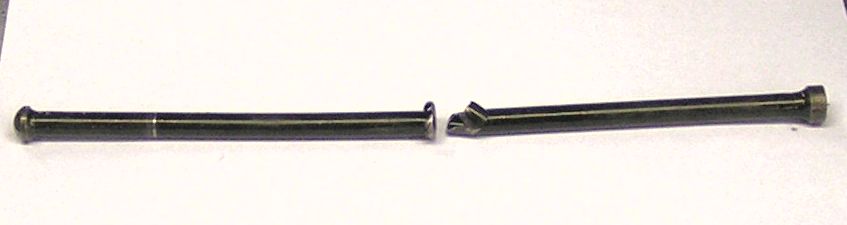

Thought I'd share some photos of this one.
Car (Morgan +4, actually - with the stock TR3 motor) was running great while putting some pre-delivery miles on the old girl - we are nearing the end of a loooong restoration process.....
On the last leg of a longer test run, it developed a miss. I found ZERO compression on #3, so I pulled the valve cover and found the damage. Valve is in the closed position.
This was a stock motor, not rebuilt - but otherwise in good shape. Compression 200 miles ago was 145 on all cylinders.
The plan is to pull the cylinder head and go through the entire valvetrain.... but I gotta admit I'm a relatively young guy in this crowd, and never have had the opportunity to deal with these kinds of failures. Frankly my generation of engines just worked, so I've never seen a broken pushrod before.

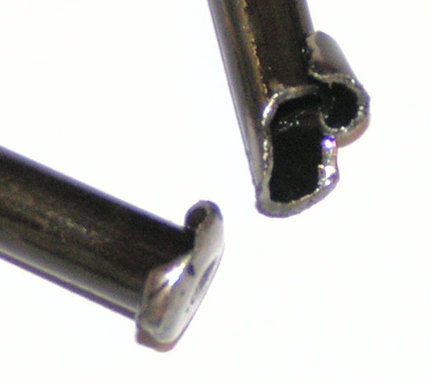

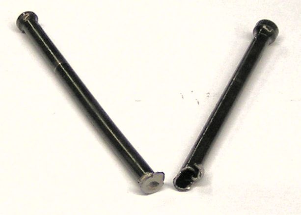

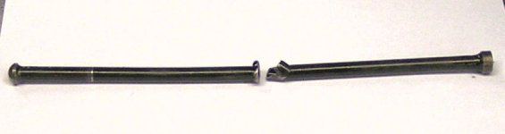

The break point seems to be fatigue. What mystifies me is that only one half of the break is mushroomed. Guess it really doesn't matter - it's gotta come apart to fix it.
Love to hear your thoughts and pearls of wisdom.
