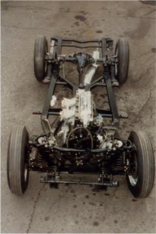

My frame is "Z28". My 1958 TR3A was "born" on Feb. 14th, 1958. The Comm. No. is TS 27489 LO. This is how it looked in 1988 during my restoration. Originally, the frame was Primrose Yellow. I've driven 102,000 miles since 1990.
Don Elliott, Original Owner.

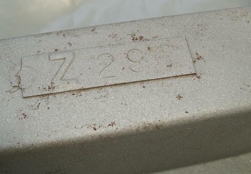

My car seems to be a mix between a 58 and 59. I could only see the "Z" standing proud, but after the frame came back from sand blasting, I can see 29 stamped next to the Z.
