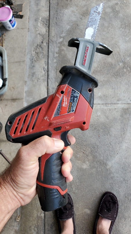

Otherwise the fall-back.... Sawzall - not often my choice because they can be very destructive by accident.
Dave
The chain type cutter can be handy for doing a neat cut on the vehicle for a repair/alteration type job, if there is access of course.
