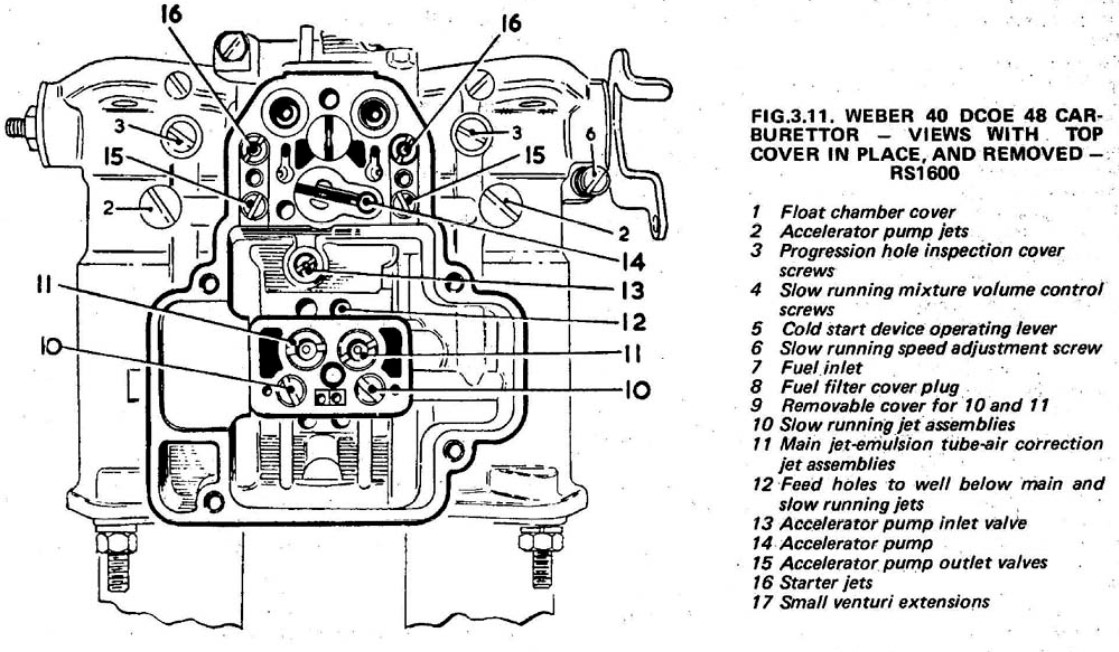

My gut level thought was that the jets for the fuel in the fuel enrichment device, or starter circuit, or whatever you might want to call it (as long as you don’t call it choke) were too big. Here is a diagram of a DCOE to further confuse you. Ignore all but item 16.
Turns out if you take the top off of a DCOE you can find all kinds of things – much like picking up a piece of plywood on a sunny day.
Item 16 – the Starter Jets.
Out of curiosity I checked to see what sizes were available – typed in 85F9 (what came in our 40 DCOE when purchased new a couple of years ago) in the search box on www.carburetion.com. “Sorry, part unavailable”. So I called them. Yup, part unavailable.
I get the idea that the 85F9 if the standard starter jet supplied in new 40 DCOE’s. I guess it doesn’t really matter since folks seem to believe that fuel enrichment devices don’t work. Hmmm. No fuel jet options and the devices don’t work. Wonder if they’re not working might be because the 85F9 jets are not right for every application for 40 DCOE’s?
