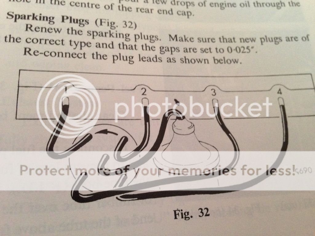

Bill, I think you installed the distributor one turn off. If one valve is tight, spin the engine once around and try again for tapped looseness.
well... after almost a month and pulling my hair out, i finally figured it out. i put new points and condenser in and the car is running like it just drove off the showroom floor. I cannot believe that's what it was. after receiving the new parts in the mail and looking at them, the actual points are so much "bigger" than the ones I took out. They are almost double in size. I cannot believe that one simple thing was driving me crazy like that. Thanks to EVERYONE who chimed in, offered advice, offered help.... i learned a TON about timing. Good thing is, I was able to put the rotor back in so that it points to where it is supposed to (it was a few teeth off) and everything looks like the "pictures in the manuals." Thanks a ton everyone... huge, huge help. I cannot believe how well this car runs now. Better than I imagined.
