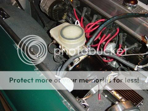

That booster and master look right at home in there, my friend.
Looks like we'll be seeing you and Deb on Sunday.
