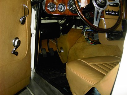

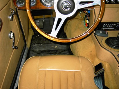

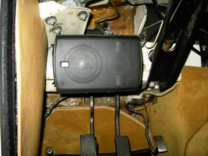

Here's the pics. I've finally figured out how to include them in a post, though I have yet to figure out how to configure them properly. The first is from the driver's POV, where you can barely see the dark bottom of the speaker. The second is from below the seat, looking directly at the speaker. The third is outside the door, down low, looking at the speaker.

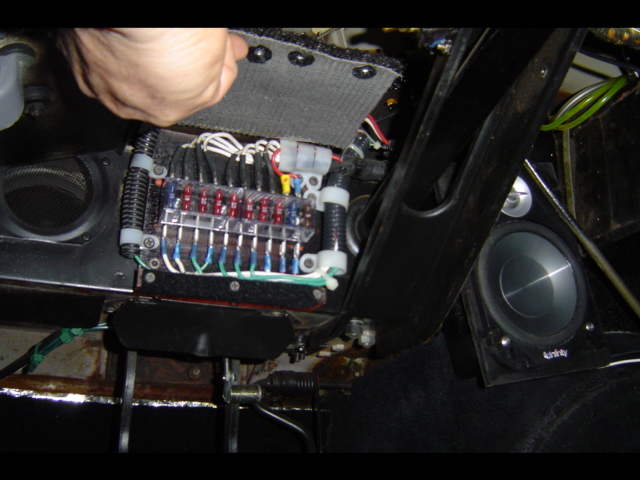

Dash Speaker pics and head unit.

I had to put my lower speakers toward the inside since I had my fuse panel where most folks mount the lower speakers. You can also see the arm from my Watson street works brake light switch.
