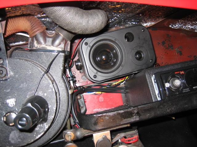

I'm for good tunes in the Healey and have had a radio and CD changer on board for several years. The quality of the sound is even better with the recent addition of the hardtop.
I have four speakers--two box speakers (about 5"x8") in bracket mounts behind the dash and two 6" flush speakers recessed in the kicks. Mounting and balancing speakers is the easy part.
What's difficult is where to put the other components (receiver and CD changer) so that it "looks right" and is easily accessible and functional. This is especially so in roadsters that lack a central console and, at least to me, are not complimented in appearance by radios, etc. hanging out under the parcel shelf or sitting on the tunnel.
I'm attaching one photo to this message showing part of what I have come up with--the Sony receiver mounted out of plain sight on the parcel shelf and the most important component: The Sony RMX4S "Rotary Commander" shown mounted on the heater motor face. (The box speaker is also shown in the photo). The 6-disk CD changer is shown in the next message.
The heart of the whole system is the Rotary Commander and mine is mounted inconspicuously, yet falls easily to hand and allows me to change function (CD, FM, AM, etc), disk and track and volume all "without looking" just by twisting the stacked knobs. It is probably 4" by 1" and is wired, along with the receiver, to the changer in the boot shown in the photo attached to the next message.
Sorry I don't have the model numbers for the Sony receiver. The changer is CDX-CA710X and a visit to the Sony site will show which units are compatible with the "Rotary Commander" controller.

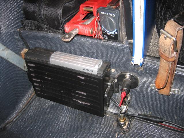

Here's a shot of the Sony six-disk changer mounted in the boot. BTW I first had both the changer and the receiver mounted in the space to the left of the spare (An option available only to 100 owners)but felt that it was helpful to be able to see the LCD display for the station frequency when using the radio, so I moved the receiver to the parcel shelf and remounted the changer as shown to allow me to stow jack, tools, etc. in the storage nook.

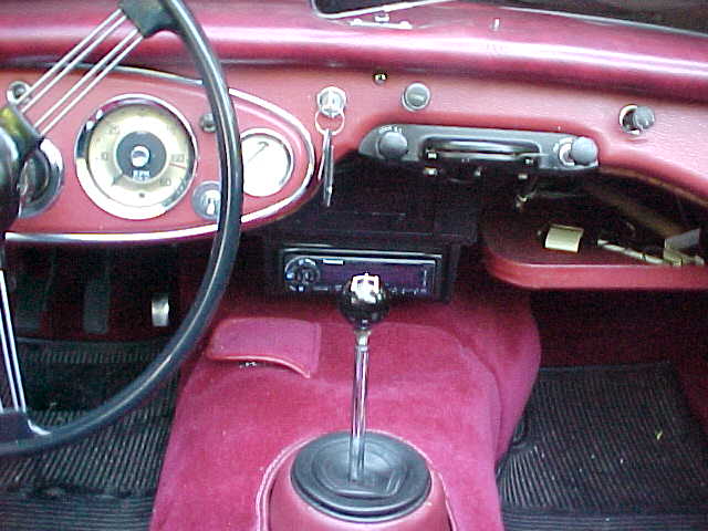

There is one more consideration in modern radios for the BJ8 crowd. The original style radio had volume and tuning shafts that helped anchor the radio in. The DIN style radios today fit differently. Here is a before and after shot of my console modification. I would think most people wouldn’t want to do this, especially if your car is all together. Just something to think about when shopping.

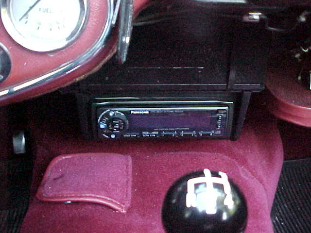

heres a pic.of my bj7 install,although its an updated unit i dont feel it insults the the intended cofiguration of the interior layout,i purchaed a plastic mount from j.c whitney $6.00 fits exactly under heater box where orig.motorola was mounted[i have it and it still works any interest let me know] o.k. so i painted the two shinny metal straps on the heater box,whip me with a noodle. with the help of gregw,ive reolised what went wrong with the sound,it was speaker placement not the radio or need for a pre amp etc.etc.i never intended my car radio to be able to do what any home system is capable of,just needed some clean sound,my bigest problem was not baffling [inclosing] the rear speaker.thanks all for your interest and responces,didnt know this would be such a hot and timely subject.now keoke,can you give me any ideas as to were in the healey i can place the two 14" video monitors?
