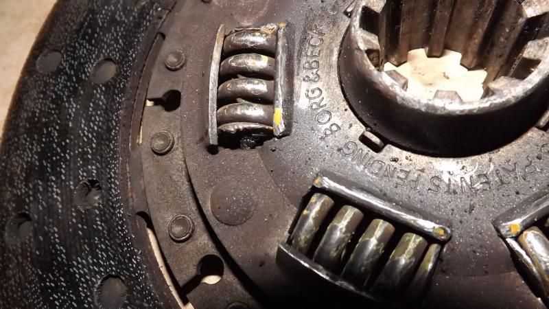

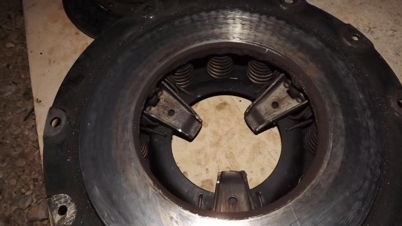

Pressure plate and clutch is out and they look just like all the pics of bad parts I found on the innerweb. I found displaced metal on the Pressure plate ears (on the oppisite side of the release bearing contact point) and the clutch disc where the 6 spring retaining openings protrude. That was the noise I heard!!! There looks to be a good deal of meat left on the clutch disc, .3180-.3220" But i think the disc is 40-45 years old. So... Pressure Plate and Clutch disc are on the way. I'm going to have the fly wheel resurfaced while I'm waitng on the parts. I'll be pouring over the net for torque values soon. I installed the new MC and got good results, No more hydraulic lock...I'm looking at a week on the inside for another attempt at a round trip drive.

The pictures of the disassembled clutch indicate to me that the Master Cylinder is the problem here. Sure, this is a good time to replace the clutch assembly since it's apart, but seeing the shiny wear spot on the pressure plate forks shows me that the throwout bearing was pushed too far forward, which would make the metallic noise, metal shavings, etc. Perhaps you couldn't move the car because the throwout bearing had slid so far forward that it jammed (hooked itself) on the front of the snout? This would make noise, keep the car from moving, enable you to shift through all gears while engine was running, and make the pedal unresponsive. A master cylinder with the piston pushed too far forward would cause exactly all of these things. I might add that if the clutch slave cylinder rod (or pedal to master cylinder rod) is adjusted too long with no free-play, can also cause this problem. In any case, the problem here is Hydraulic, not the trans or clutch itself.
