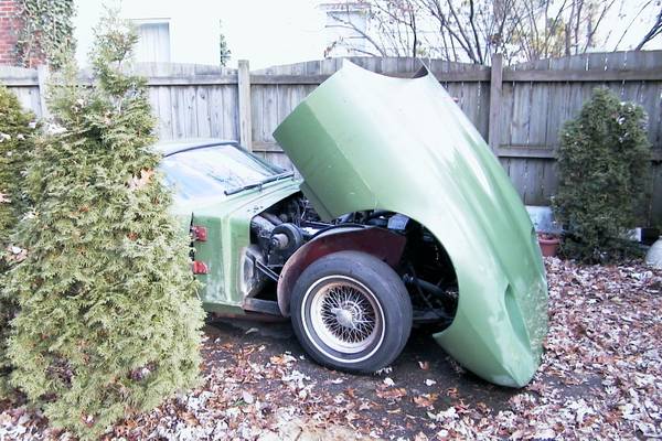

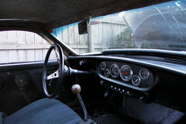

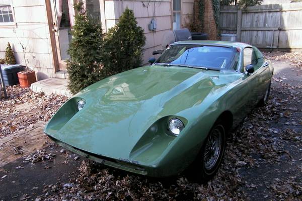

I borrowed a buddy's van and rented a U-Haul trailer and am in Columbus right now to pick up the Green Jamaican.
It's a 1957 100-6, BN4L O 28007, O28007 on the title.
The cockpit looked workmanlike, good looking SW gauges and the doors open and shut. It's raining so I didn't uncover it anymore than that. Will post pics tomorrow.

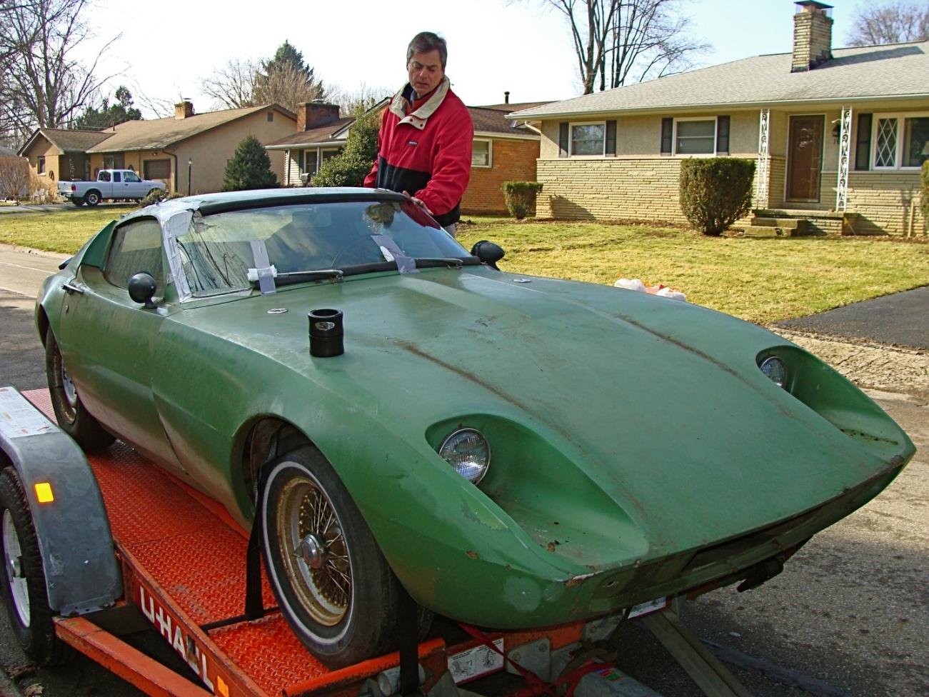

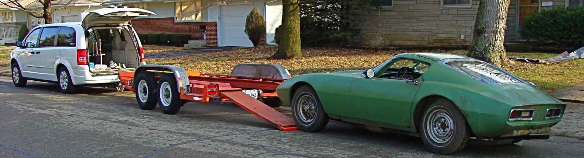

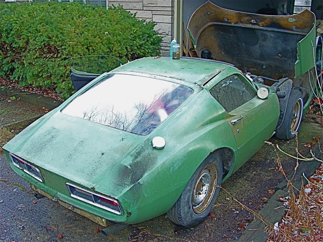

Picked it up today, Graham the owner was a good guy. His father was a Wellington pilot from NZ. We liked the same cars and airplanes. He didn't really do much to the car, just kept it in one piece. The car has been in the Columbus area for 40 years by the paperwork I have.
A previous owner chopped into the top to wedge a little more headroom. A bit of repair, but at least they didn't cut through the main frame rails.
The Camaro tail lights make it so the gas tank doesn't fit, so someone cut into the bottom of the rear body. I think I'll cut off the back of my white one and graft it onto the green one.
The frame's good, one outrigger needs replaced and some accident damage rt front and rear but not too bad. I've recruited a friend Dave that did some work on my MGB way back (and deconstructing the Swamp Rat) to weld the frame and correct the fibreglass to my desires.

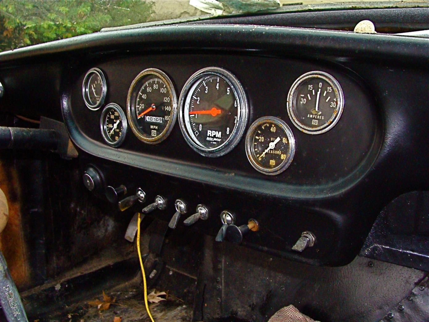

The engine lights right off. Nice to hear a 327 again, I've loved them since my parents had a twin engined cabin cruiser with them. What a great soundtrack. The instruments work except the oil pressure gauge needs something, probably replacement.
Here are a few pics.

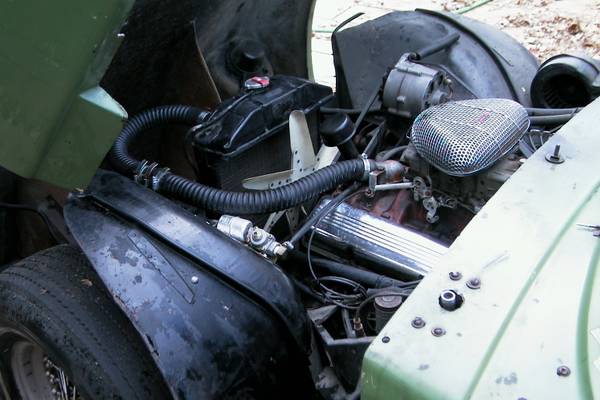

Looks like a much better starting point than the Swamp Rat. The 327's a plus (they were all Corvette engines, you know. At least everyone I ever saw advertised was, even if the came out of an Impala and had a two-barrel). I'd look around for a new air cleaner. That one has a reputation of collecting gas fumes in the foam and with one backfire ... whooomp!
Yeah,
This one has a 4 bbl so it must be from a Corvette, right? I think it's all from a Camaro in reality, just like the door handles, ignition switch, light switch, rear end, rear wheels, and those gawdawful tail lights.
I take air cleaner off when I run it, it's to keep the rain out I think! New stuff will be on order soon. It ran great at 40F yesterday, could only get pops and a little fire today at 26F.

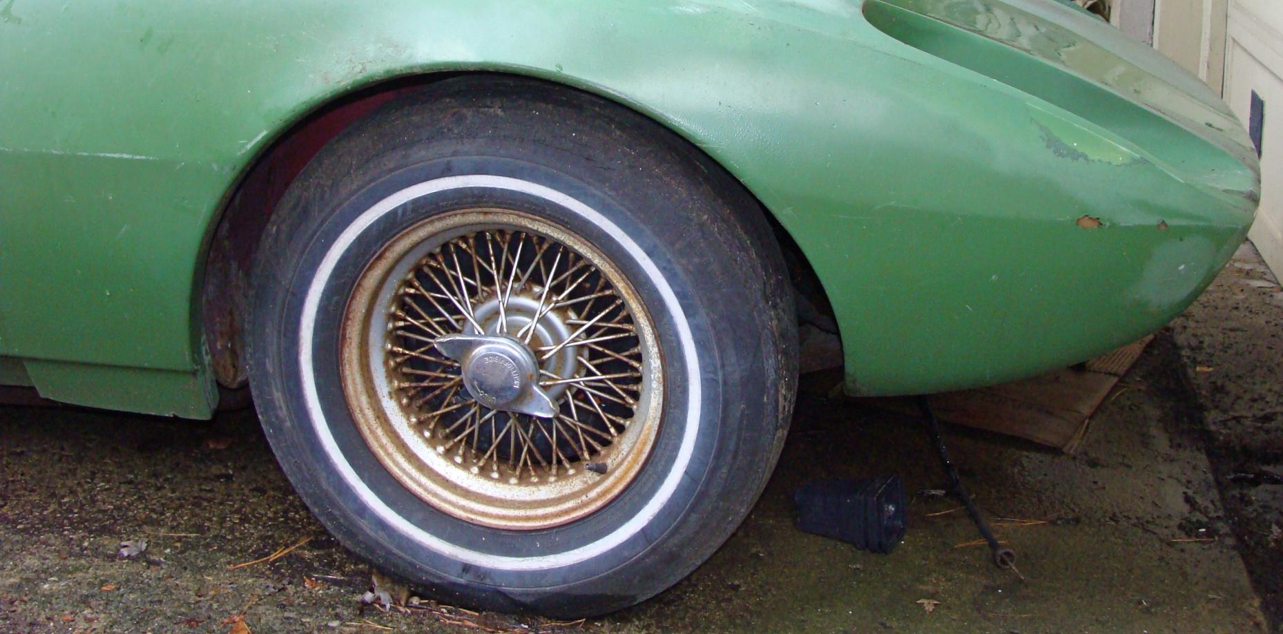

If you've got 4.10s in there with a 4 spd it's going to be a screamer ... literally. Probably not pleasant for any freeway driving. I'd be looking for a way to drop highway rpms and the 3.54 is one way to go if you stay with the Healey rear. It's probably a good time to sit down and plan what you want to do with the car. You need to look at it as an entity and see how everything is going to work together. So often one change can impact other stuff downstream that you never considered. For example, start thinking about wheels. If you want to stick with wire wheels, staying with the Healey rear is a good option. But spline drive wires aren't the best option if you're going to wail on it. I'd be looking at the Dayton dental drives for the rear: https://www.britishcarweek.org/scuttle.html The steel wheels on the back of your car are the first sign of a V8 swapped Healey. Other options to drop the rear end ratio is to fit a Camaro T5 five speed, or you could do both, a T5 and the 3.54 gears. The other option is to fit an American rear axle, complete with disc brakes and whatever ratio you want. The other thing you're going to want to investigate is how to keep the motor cool. If you've got a standard Healey radiator in it, it may not cope with SoCal driving. I'd be thinking of a new cooling system and air conditioning. That car is going to be a roaster (not roadster) inside in the heat.

The open circuit that kept the engine from starting was the voltage regulator. I thought it was the switch for a while. We jumped around some stuff and figured that one out. Custom wiring job, positive ground that they seem to have copied from the Jamaican manual, pretty simple. I'll get a new regulator this week.
I fixed the oil pressure gauge I think, plastic line was cut in two.

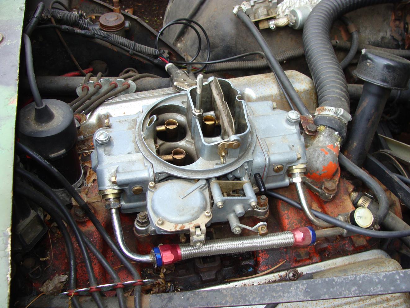

The voltage regulator's main point set was rattling around in the case, I opened it up and the interior looked new. The outside was plenty rusty along with most of the wiring connections on the whole car. A light surface coat of rust. I got a new electronic replacement from NAPA and didn't feel like getting any wetter so covered the car and went to the garage to clean some stuff. It was fruitful, but I can't wait to get it running again. I bought a gas pedal like Healey Rick's, should do the gas pedal and choke cable next time out.
