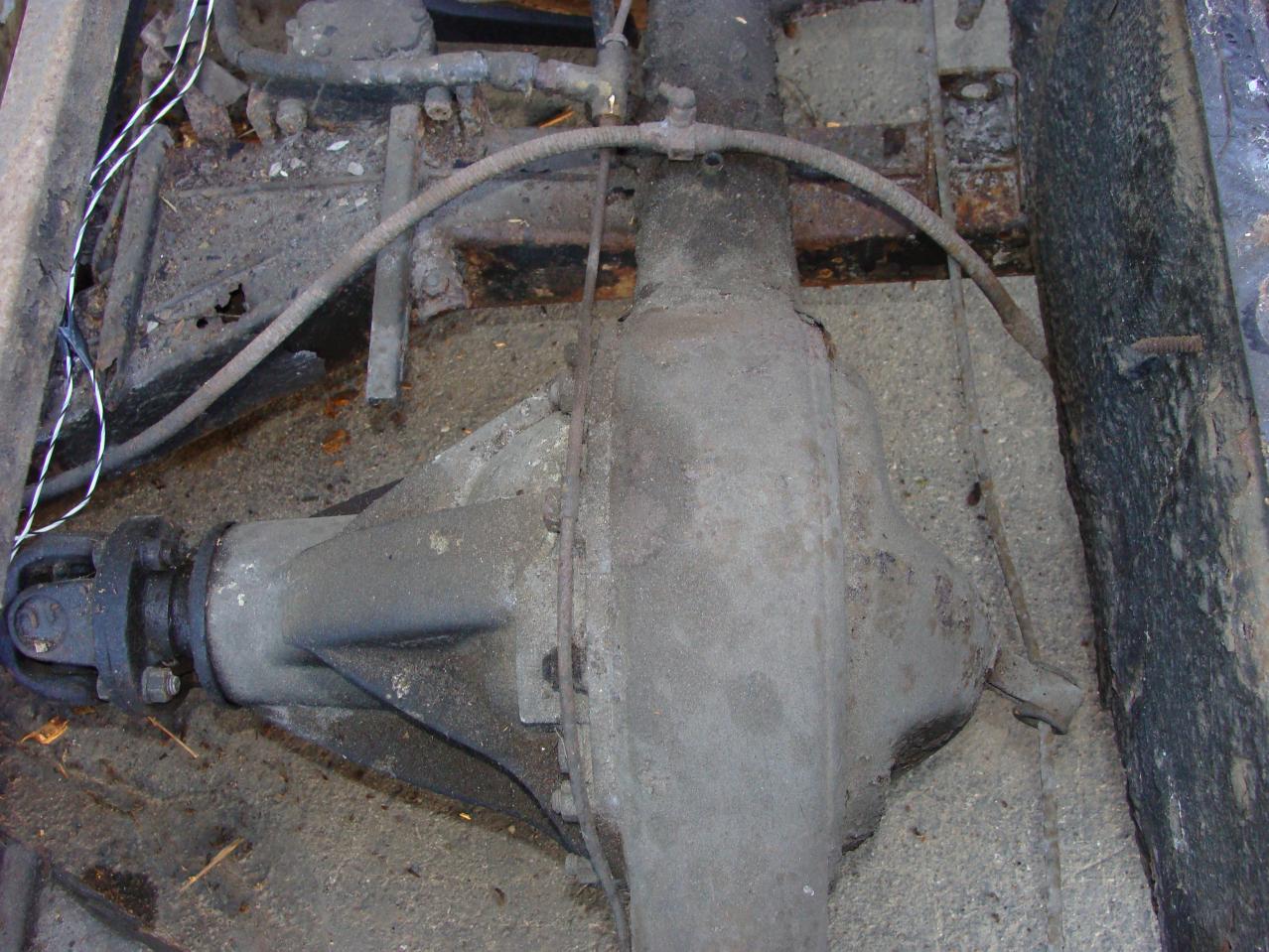

The Swamp Rat is really showing the effects of her care. I couldn't get a jack under it and the left side frame rail failed when I jacked it up from behind. It still stays up but once on the ground it lies flat on the ground in the front. My only choice that I can see is to remove the body from the old frame and build up the new one.

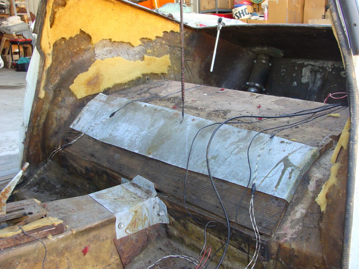

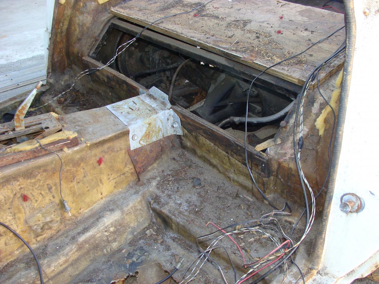

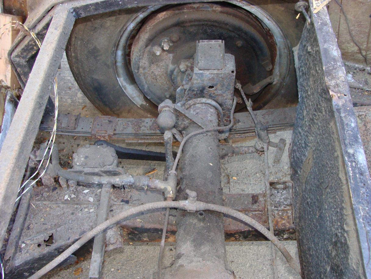

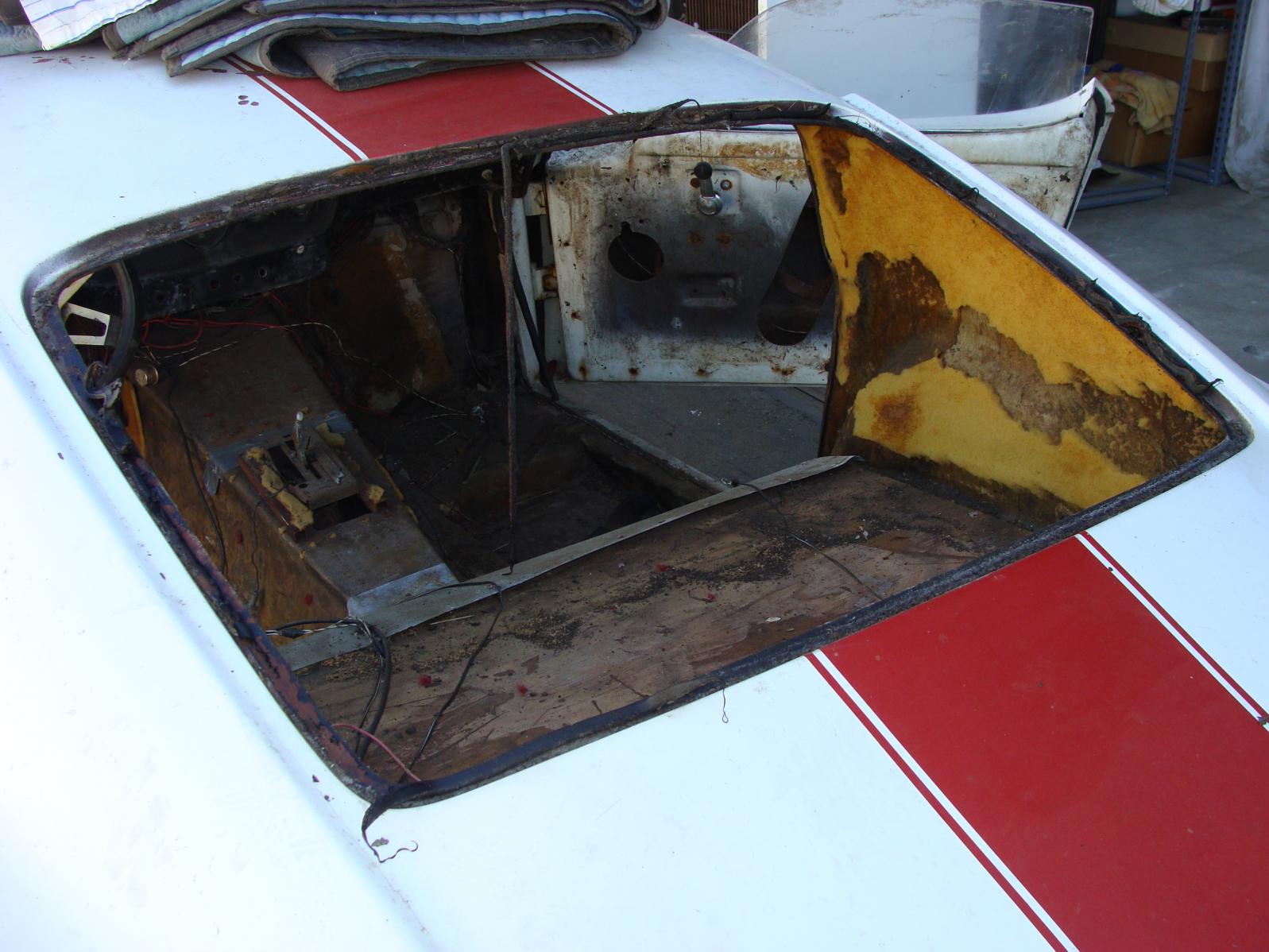

I removed the rear window by heating the tape and removed the axle hump covering, 3/4 ply and roof flashing is top notch material for kit cars. The fasteners were five different kinds and sizes, 10mm mostly. Not too British.

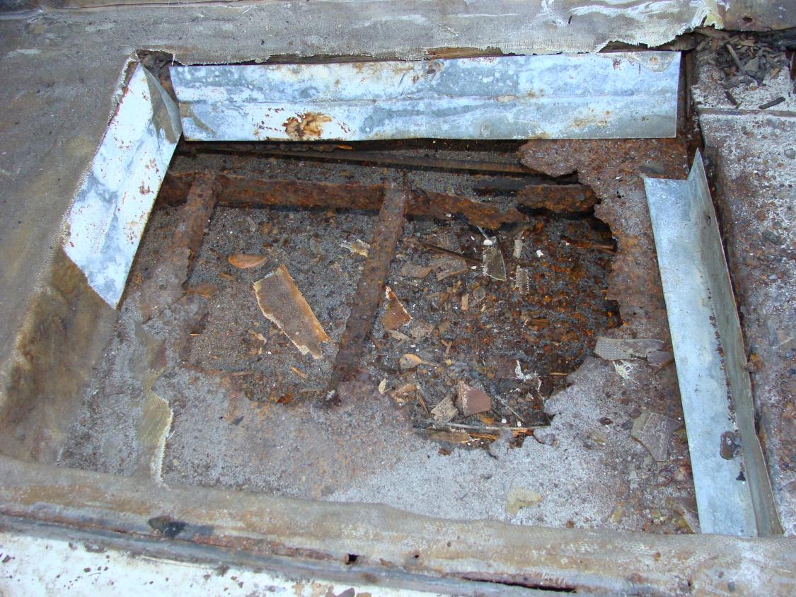

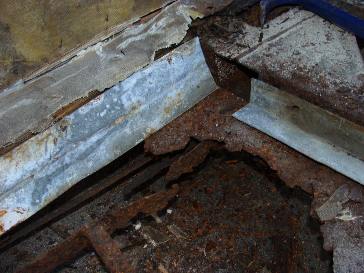

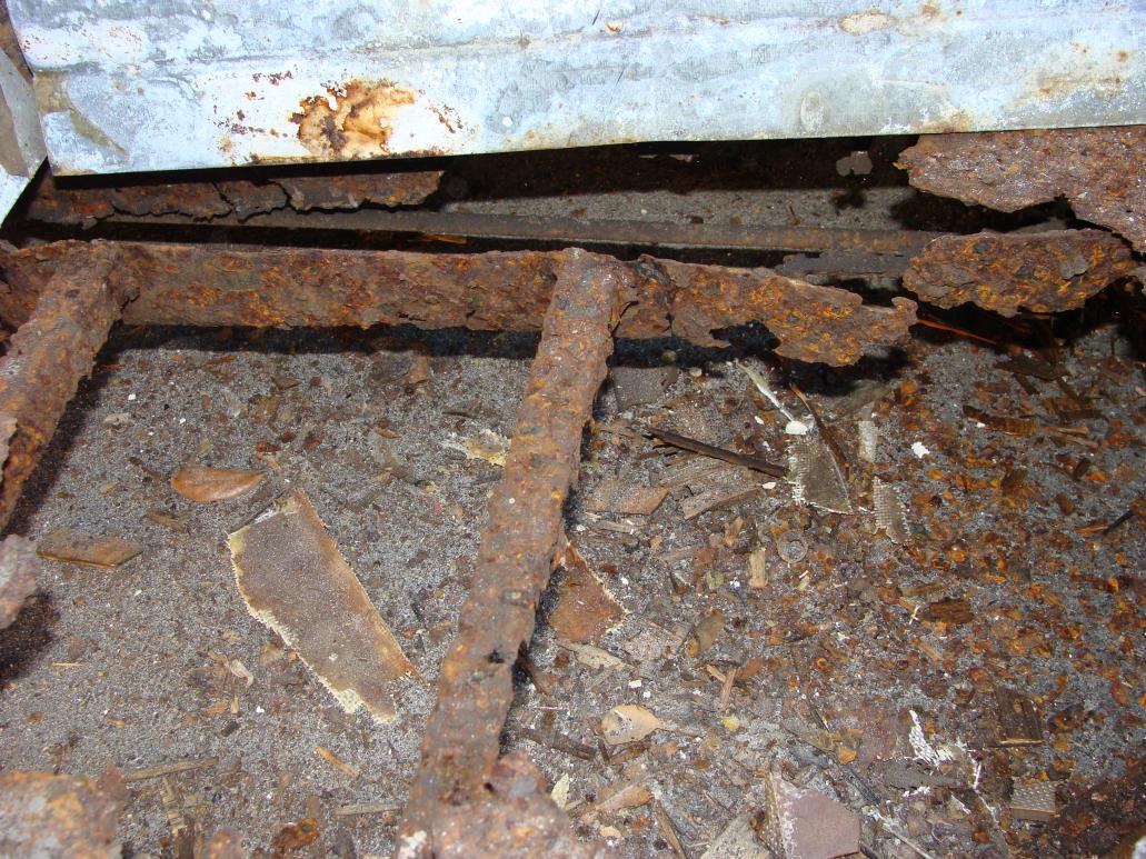

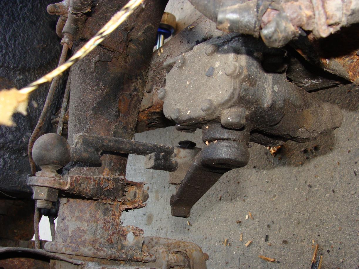

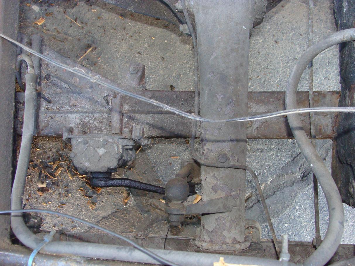

I wanted to see where the frame failed and the floor seemed to be ply, fibreglass and metal so I got into it with an angle grinder and a crowbar. It was fun, but what i found was not too pretty. The builder cut the frame rails down by cutting the rail at a 90 degree angle and didn't box it in, if that even would've helped. A sheet of steel was evident over the top of the rail but not being closed up on the vertical cuts I doubt it ever would've lasted without failure long term. The seat pan areas were fabbed out of roofing flashing and glassed over.

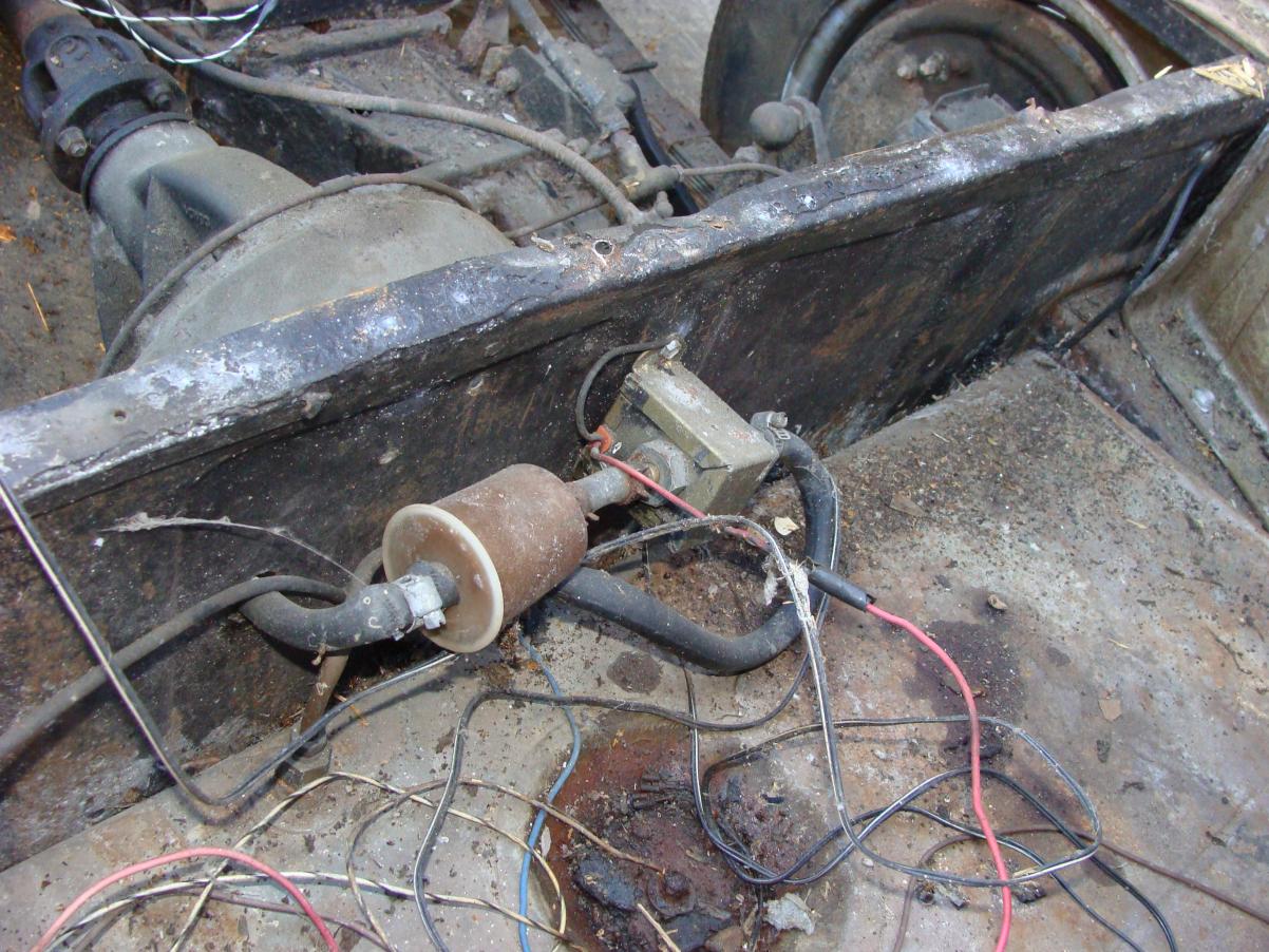

Underneath there are small square tubes building up the outboard areas, the hump and along the rear where the the body is bolted are also small square tubing structures. Are these Healey, or custom?

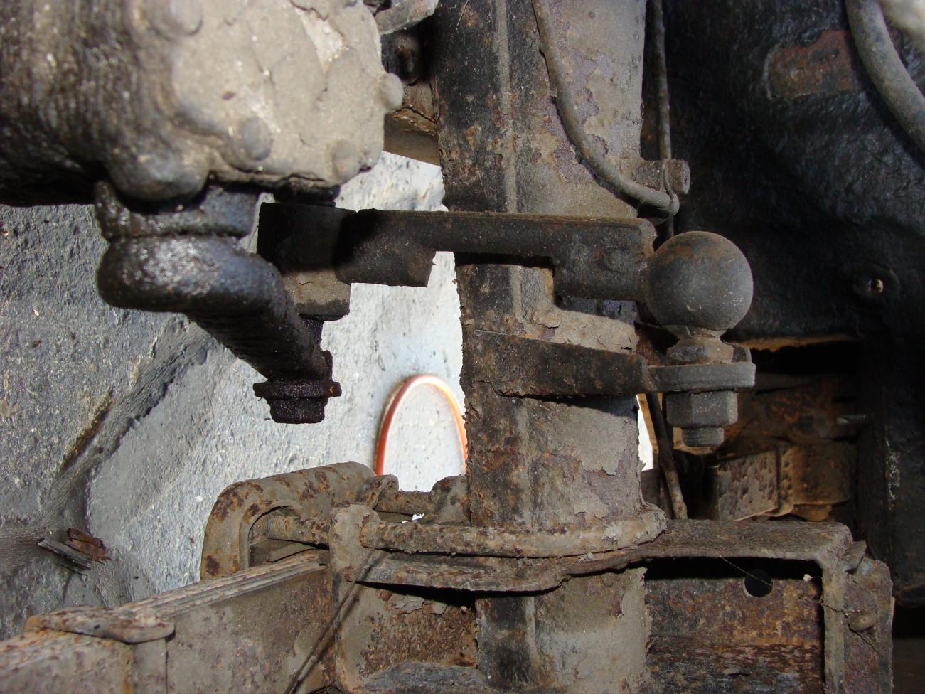

The rear end looks like a Healey, it says MOWOG on it. There is some emergency brake stuff there, but the handle isn't mounted to the flange though the cable casing is there. A few parts here and there should restore that system. I guess the shock links needed to be shorter, REBAR being a well known structural component of many race cars it's used here as well! I had to laugh. The rest of the stuff is fairly stock with stock fasteners that I can salvage, thank goodness.

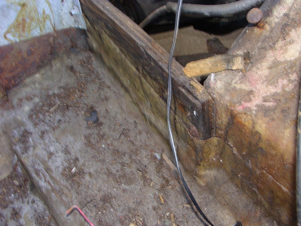

The tunnel is made of 3/4 inch ply and covered with glass cloth. I started to cut it off at the base, but not really knowing how the stock structure is and how strong the body would be without it I stopped and have a few messages to send to known Jamaican experts. I think it'll be OK with no floor or tunnel but...

Here are some more, the floor drop with main frame rail cut left open is just special.

Don't know if this has been covered yet, but it looks like a 100 frame (90" wb) with a BJ8 rear (differential).
What's on the title or registration?
Bob
Tennessee assigned VIN, 1973 build. I thought the same about the frame, 90 inches and a straight radiator brace. Too bad the frame is history.

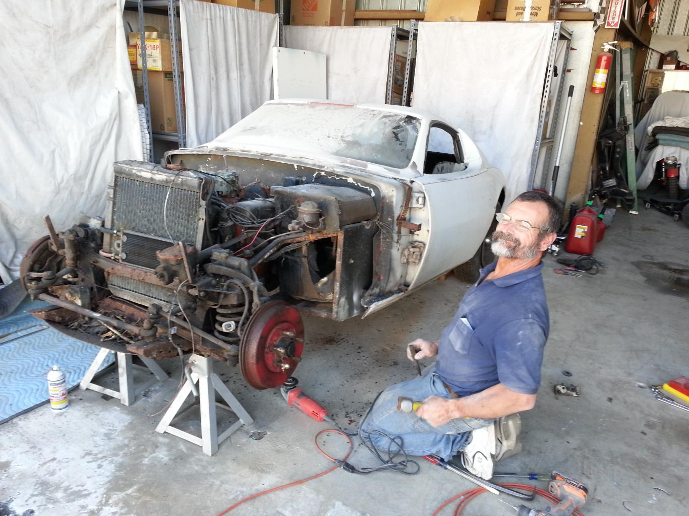

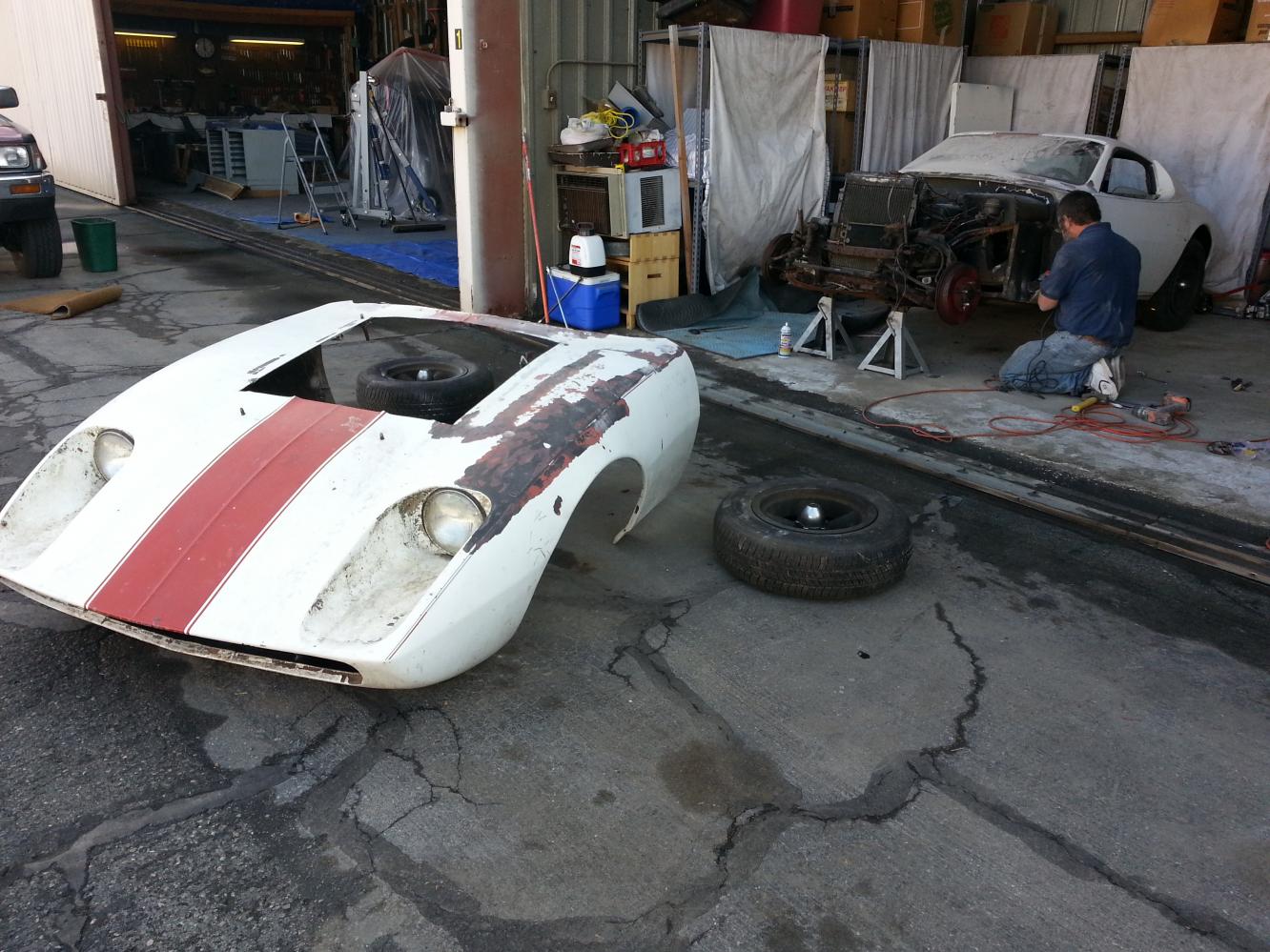

Here are a couple from today, forgot my camera so my old buddy Dave is caught by my phone. Body is off now, but it was late and I didn't take a picture.
Chris...
