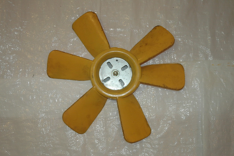

Yep looks like mine TC except mine was originally white when I purchased it 35 years ago. I recently painted it yellow.
Ditto. (I've been a member of the NTAHC, who sold them, since the club started)'Mine too. I have never seen one yellow unless it was painted.?

I have done a few experiments with mechanical fans, and found that you only have depth for a 2 inch deep fan. I am currently running a 15 inch flexilite plastic fan that is 2 inches deep (model 415 I believe) and I have about 3/8 inch to the radiator tank in the front, and about 1/4 inch to the crankshaft pulley in the rear. I had a 14 inch Texas Cooler from Moss on previously, with the Kilmartin shroud and the flexalite fan with a custom shroud almost doubled the idle air flow (measured with my trusty german made car synchronizer).
