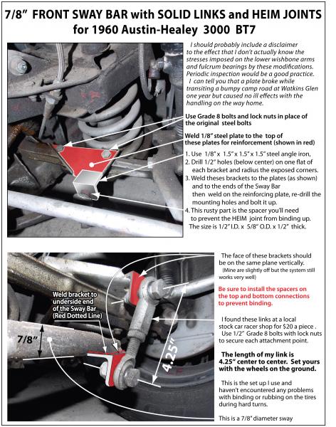

If you're still interested in this topic here's what I did to my 1960 BT7:

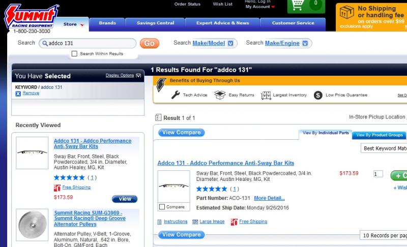

1-Added a slightly larger diameter front sway bar with solid links and Heim Joints.
2-Get a set of Bridgestone Potenza RE 960 AS Pole Position tires or current model @ 195-65-R15
3-Add 3-4 leaves to the rear springs
4-Put a sway bar on the rear with solid links and Heim Joints
Now Go out and enjoy all those high speed corners you were afraid of.
steveg
I like your adaptation of the rear shock links for a sway bar.
I added one leaf as there's an extra 1/4" of space in the keeper loops. Don't see how there would be room for 3-4 more without a completely custom spring. You'd need longer u-bolts for the axles for starters. FrameMan I think would agree 3-4 extra leaves would make the rear end much too stiff and be tough on the frame.
