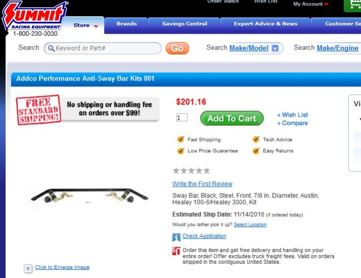

Yes that sounds good, I'm afraid the 7/8" bar might be overkill.
Mine might be 7/8" ... I don't recall what I bought and the car is at my folks'. It was one step (1/8"?) larger dia. than stock. Be sure to get the end link kit; the stock links will not handle the additional stress (first-hand experience).
steveg
That's a sprite/midget bar.
I stand corrected - here's the big Healey correct bar - evidently only in 7/8" and looks like a special order with the long delivery time:

Cape International sells a 19mm (3/4") bar with links for #187.20 = $242.75 plus shipping
Yeah so that pretty much makes the Moss bar the same price. I am afraid the 7/8 " bar may be too much with now rear bar and I don't want a rear bar.
