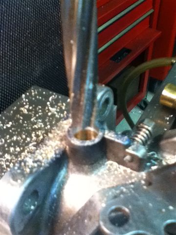

Update:
We took the plunge and first ran a 0.340" precision drill through, which confirmed that the bush is captive and installed at time of manufacture. We then ran the 3/8" reamer through and noted that it did not remove all of the bush material, so the bush OD is larger than 3/8". There is also one spot where the "parent white metal" has overlapped the bush material i.e. there is no definitive ring at the bush edge.
The new bushes were then pressed in with an arbor press until the bush penetrated into the choke, but with the top and bottoms flush to the choke. Now came the challenge of matching the profiles of the bush to the choke. As a test on the first bush, we used a short length of DOM 1 3/4" x 0.250" wall, ground a small cutting edge and turned the "tool" in slowly by hand. This did a great job and we finished with a near perfect smooth surface at the face of the bush to the choke.
Full speed ahead then, so in went the second bush only we out-smarted ourselves thinking that if one cutting edge on the "tool" was good, three would be better....What a mistake! We forgot to clean a small burr. The cutting action on the second bush forced the tool off a few thou, and we finished up with several nasty grooves about .006" deep in the choke!!!.
So, we solved one problem with nice fitting shafts and bushes but now have another "selfmade-out-of-stupidity" problem to rectify. Onward and upward

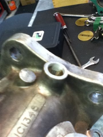

This shows one area where the parent metal of the carb overlaps the OEM bush - after the 0,375" reamer went through.

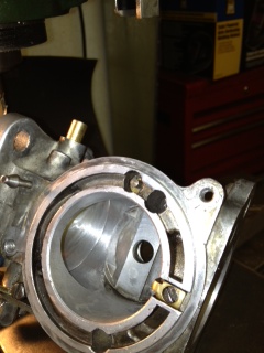

The choke bore profiling "tool" that went wrong. We should have left it well alone with a single cutting edge and all would have been fine. This tool also helped to support the carb while the new bushes were pressed in - the bushes were pressed to the correct depth and only required a few taps to get the top and bottoms flush.
We now have a bigger challenge. The solution is likely to machine a new choke and press that in..........

A .006" scratch is mostly cosmetic. I do not think that will affect the operation of the carb, so it's just a matter of how much of a perfectionist you are!

John, you are probably right, but it looks quite bad as there are more than one gouge, and they are close to the closed position of the butterfly. If someone else looked at the carb in this condition they certainly would wonder who and why was the it butchered like that. Also, my friend feels that it reflects poorly on his maching efforts, so I know he won't let it be no matter what I might offer (he may have done something while I was away?).

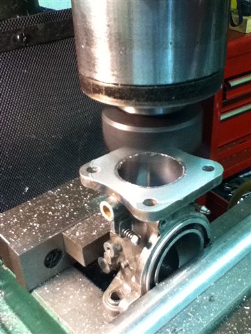

In my absence, Al bored out the carb choke and made a new choke about 0.090" wall out of aluminum tubing. This was pressed in the end faced off. He used metric size cutter to bore through the new choke material, and a regular drill to restore the vacuum hole. All seemed OK but obviously not perfect - probably 0.030" off centred. This meant we had to make a new brass spacer washer between the lever and the body at o.020" (versus the original at 0.030"), in order to get the butterfly to centre OK. You can also see some daylight at 2 and 7 o'clock when the butterfly is closed but it does not seem any worse than the other carb.
So job done, but the proof is yet to come when I try to blance and tune. There were also some other niggly bits which had to be looked at - a sign of how this carb has had a hard life

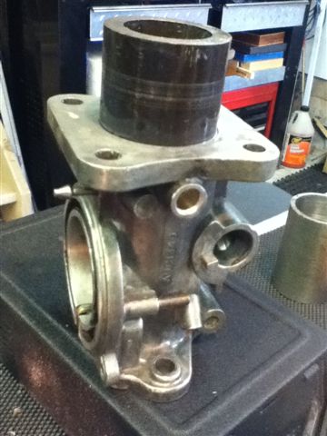

here is a picture of the finished job

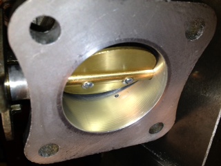

Not sure if this will show it but the new choke is around 0.030" off, but we think it is ok since it is on the axis of the shaft.

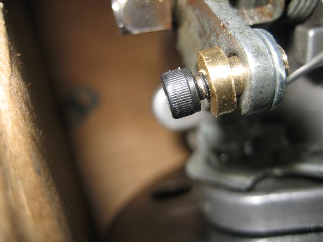

One of the "niggle" items was that when I took the carbs apart this one had cobbled up spark plug tip for the choke lever spacer. Al made a new one from ali bar stock

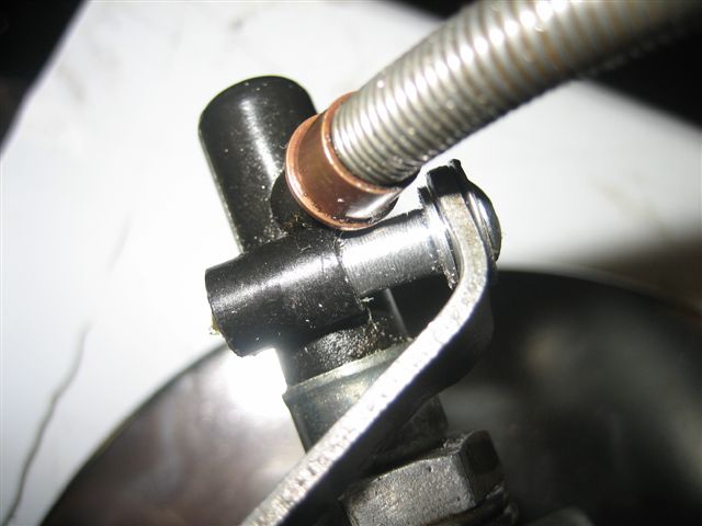

The other niggle item was that the choke cable was bolted firmly to the carb choke lever, so when the cable bent when the lever went through it's arc when pulled. This made the pulling the choke harder than it really should be - new one made where the longitudinal bolt clamps onto the cable.
