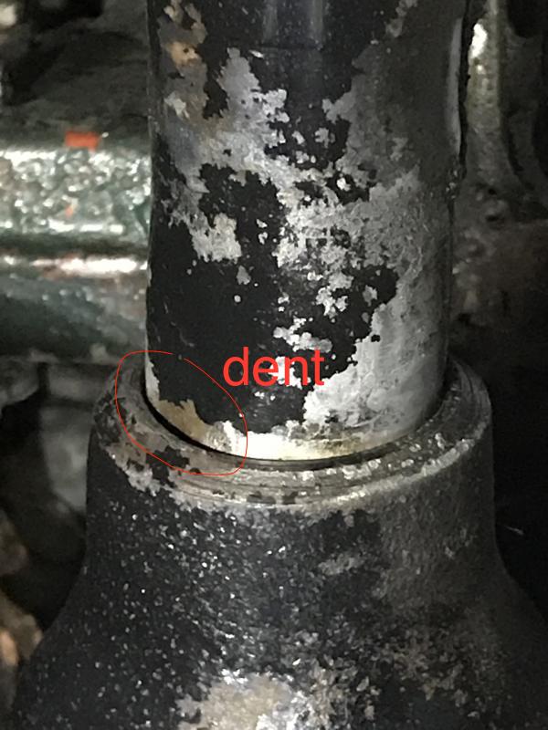

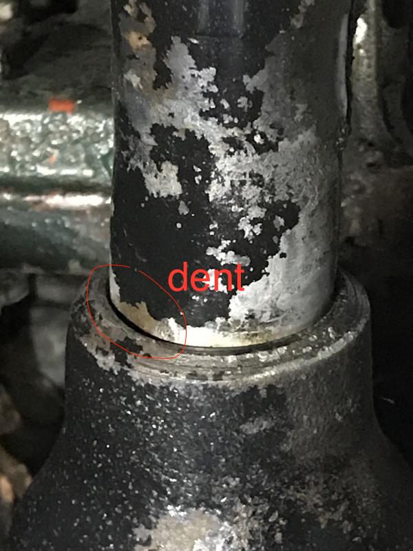

Here's a photo where I've circled where the dent is. See how the outer tube is not firmly attached, soldered, "sweated" to the steering box anymore. I can see a little oil there too. When turning the steering wheel, I can see the tube moves straight in and straight out, very little, but enough that I notice it. I don't think it's suppose to move, have any "free play" at all. The box is bolted firmly, the tube is bolted to the dash firmly. The tube has slight in/out movement where it enters the box. So, is this serious enough to remove the box and have this looked into?

I'd want to fix it.
You could probably buy a used box with column from British Car Specialists - they have lots of used parts. Or they may be able to re-solder the tube. Give them a call.
Tough call. If the tube is moving in and out, that sounds like too much end play at the worm; I think you can check this by checking if the wheel has end play (if you have an adjustable wheel you'll need to make sure the collar is tightened securely). I'm guessing the problem with end play is (even sloppier) steering, and possibly some extra wear on the worm and peg. If you need to drain the box to change the shim pack keep in mind the troubles several of us have had with the upper bearing falling down.
I don't see how that dent could have been made unless the tube was out of the box at some time, which might explain the lack of a solder bead and the oil leak. I don't think the oil leak is worth pulling the box, just don't overfill the box; when I worked on my BN2 I had the front up on jackstands, and I couldn't figure out why the box was taking so much oil until I realized I was trying to fill the tube! There is no seal except, maybe, the felt seal near the top of the tube.

Looking at my own column...the splines are 7/8" diameter, you could pull the wheel all the way out, wrap the splines with some aluminum flashing or halves of 3/4" pvc pipe - and grip the splines tightly with a c-clamp or vise grips*. (I've never been able to get my adjustment collar to be tight enough to not slide on the splines.) Then you could jiggle the column in and out, independently of the outer tube, checking for any end play. If you have end play, you need to fix it with the shims. If no end play and the shaft turns easily, then maybe you could clean the joint with some brake cleaner and fix it with green wicking loctite.

I think the tube was damaged during the engine removal or reinstallation. The solder joint is likely a low temp solder meant to provide a seal between the box and tube so a dent that large would likely cause that solder joint to fail. I believe that will need to be addressed by removing and servicing the box. A good metal fabricator might be able to rescue the tube and silver braze that joint.

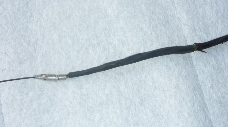

I don't think there's a magic technique to this (except patience). The leads--horn, turn signals, ground--should be trimmed to different lengths; I've had best results--read: least hassle and frustration--wrapping the end with mechanic's wire then fishing them through the tube(s) and box. Be careful not to pull the stator out of the box--can be done when the olive is off--because it can be a problem to insert it back into the box.
I've never had luck at pulling all 4 bullets through the stator tube. Have used two techniques:
1) Use soldered bullets. Unsolder bullets 2 - 4, wrap all but bullet 1 in heat shrink tube, and use a wire with a female connector to pull through the stator tube. Then remove shrink tube and resolder bullets 2 - 4 on the wires.
Note: crimp bullets can be drilled out with a 1/16" drill and converted to solder bullets.
2) Since I don't mind modifications, I prefer this technique: Cut the wires about a foot from the bullets; strip and tin the ends; connect both through a Molex connector. Pushing the wires through the stator becomes trivial. Leave the bullets permanently connected under the shroud. Molex connector can be painted black, then attached to car with super magnet.

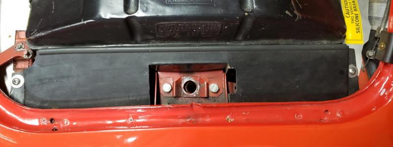

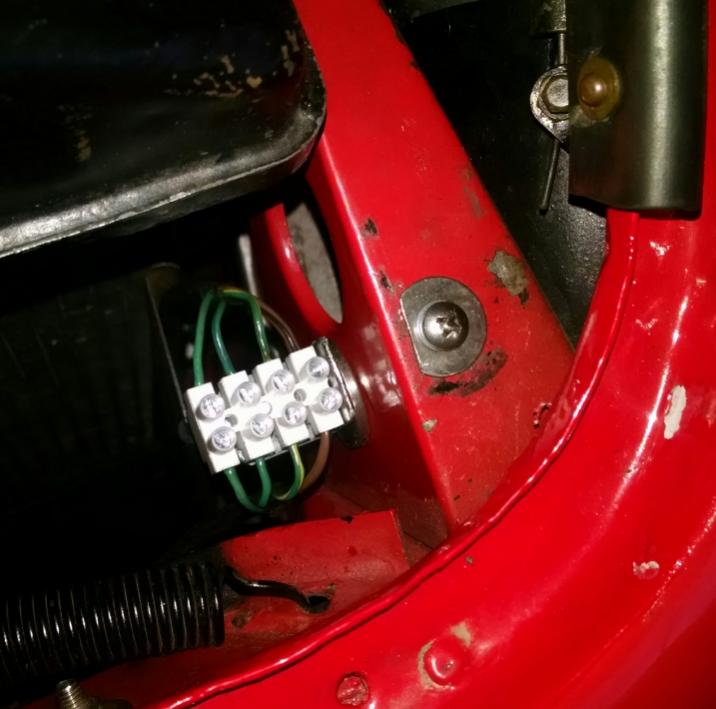

This panel hides the Molex terminal block:

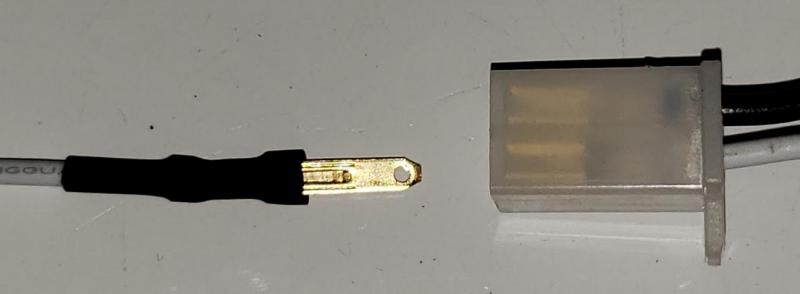

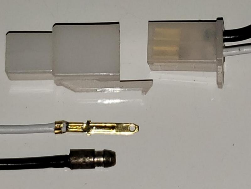

Gonzo - here's a 2.8mm male connector compared to a bullet. Looks like 4 in a row would pass easily through the stator tube.
Don't think your connector would have to be waterproof as long as you kept it up away from road splashing. You'd be removing the male connectors from the plug in order to pull them through the stator - easy enough on the off chance you'd have to do it at all. If you used a weatherproof connector such as a metripak or weatherpak, you'd have a hard time pulling it because of the rubber sealing elements above the connectors.
The screw-type Molex terminal block only requires unscrewing the wires.

Good point on the waterproofed plug. Just ordered a 4 pin connector and plan to use the smaller male pins to connect to the trafficator wires. This style I think should work. Once unplugged from the main socket the pins are easily removable by pushing inward on the barb and sliding out. GONZO

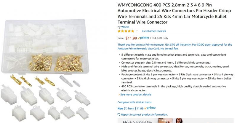

I bought this kit on Amazon:
