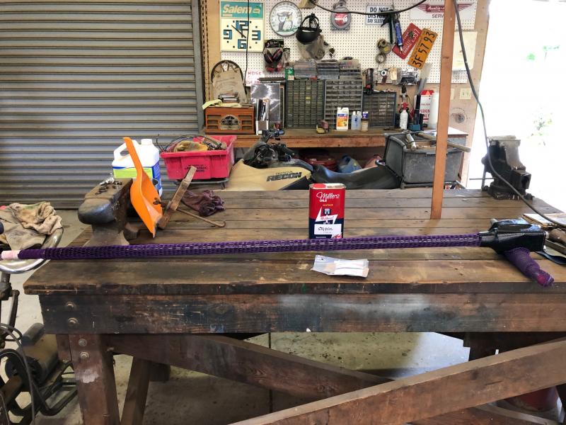

I received mine yesterday--after Customs shook me down for $75--and just got it on the bench today:
It'll be a while before I can get it installed--thanks to all that replied to my inquiry--but can provide some 'first impressions:'
  • Turning the shaft by the steering wheel end, there is no discernible play; you turn the shaft, the rocker starts to turn (can only turn the wheel about 3/4 turn due to the protective wrap)
  • The steering 'feel' is smooth as can be, no hint of binding, looseness or change in feel
  • Comes with a liter of steering box oil which, of course, will be impossible to find in the 'States
  • Item was well-packed

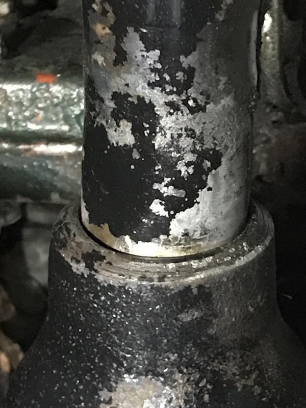

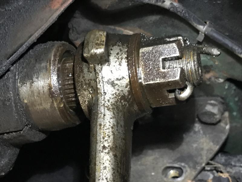

66 BJ8 steering box leaking down the steering lever splined shaft. Noticed the dust oil seal cover is missing too. No leaks at the olive nor end cover. Would sucking out what ever oil (90w?) is in the box and replacing it with the thicker steering box oil (Steering box lube by Dynolite) stop the leaking? Can the foam dust oil seal cover be cut in half in order to install with out having to take the steering lever off? Then using contact cement, glue the cut back together? I'm assuming the foam seal is only for dust protection, not sealing the oil. Is it really necessary? Notice there is a dent in the outer steering column where it attaches to the box. No leak, there. Should there be concern?
Yes. Just one slice through one side of it and it should wrap OK. Glue it with a zip tie or twist ties to hold it.
Dust only
If it wasn't necessary, the engineers would have left it out.
No leak and no steering interference, no problem.

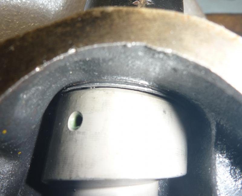

When draining the steering gear from the front plate (cracked open about 1/4 in.), either the peg or worm gear slipped. The top plate was off which may have allowed for the peg to move too. Attempts to re-assemble binds up the box. I'm working on correctly mating the peg and worm while ascertaining if the rear bearing was dislodged from the race. Is there a simple way to determine rear bearing orientation?

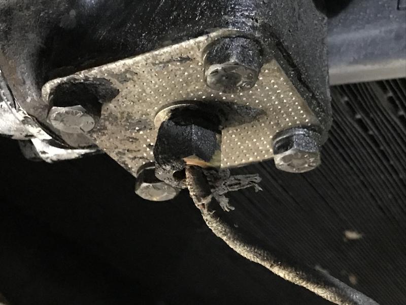

I did loosen the 4 bolts out about 1/4". The plate is stuck. Getting nervous about prying the plate out because I what I'm reading. I also removed the nut that holds the olive. Olive is stuck. No oil is draining out. I could grab the olive with a pair of pliers (why do we say "pair" lol) and see if I can pull it out. I'm thinking I should tighten everything back and use a suction gun to try and remove as much 90w as possible.

The peg goes anywhere in the worm; the steering arm will follow. Not possible to put it in the wrong place. If it feels a little off, the rear bearing is cocked on the race. Do not use it this way, it'll eat the race. This happened to me.
With the top plate off, the rear bearing, correctly seated, looks like this.
i'd hand-tighten the bolts until they're just loose - not even 1/16". Then at the two lower corners, tap a utility knife blade slightly into the joint between the front plate and housing and gently pry the plate loose. There's nothing holding it together except crud. Try to get between things and not bung up the shim(s) or gasket. When the plate separates from the housing open up the bolts about 1/8" to let the juice drain out. The stator tube should slide out the small distance required without undoing the olive.

Steve - the pic is very helpful. The steering wheel was not removed for this job and what complicates assembly is its orientation relative to the worm and peg and thinking that it must be "centered". Will it self center? Thanks. GONZO
