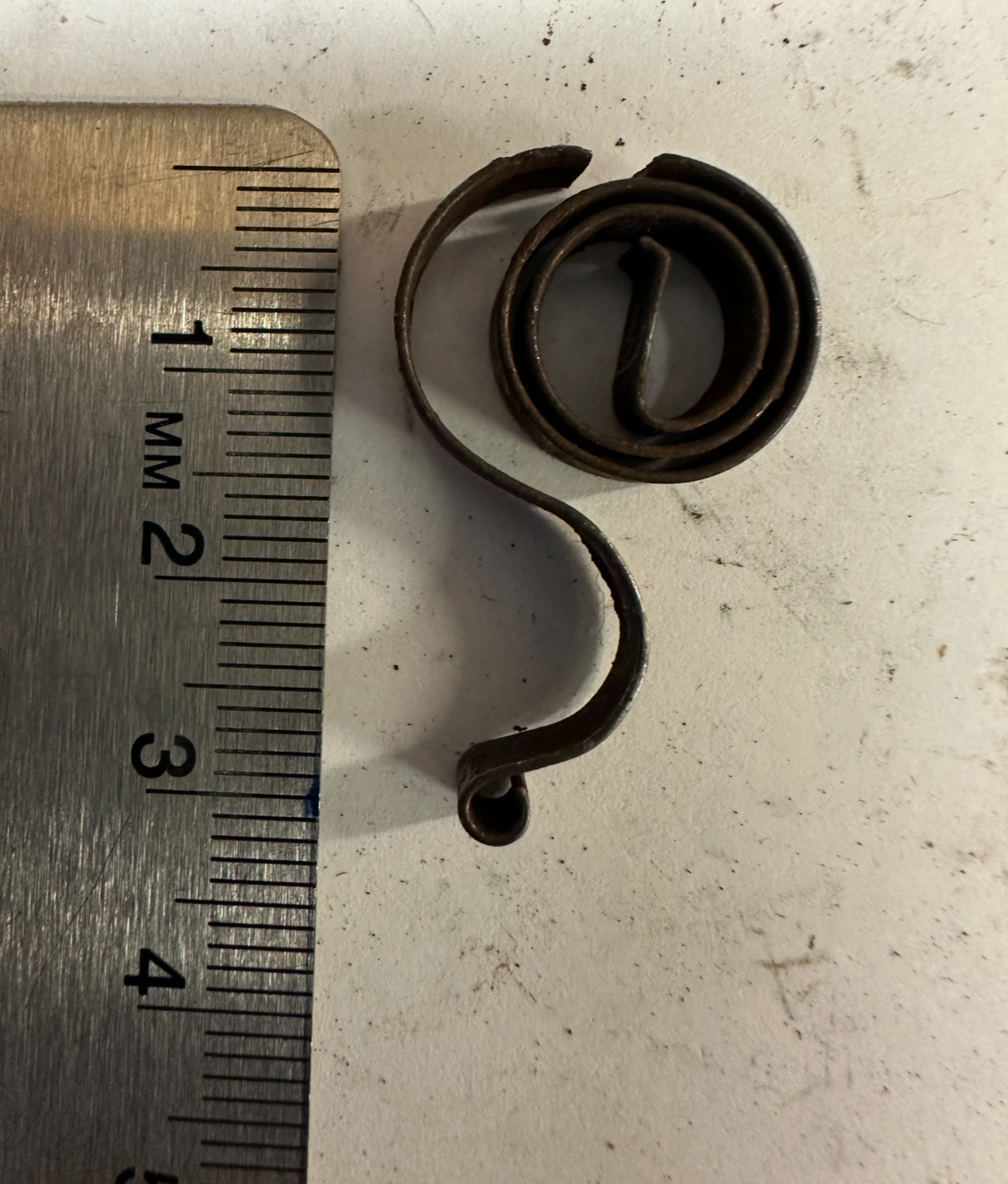

I have a Triumph TR3 that uses a version of this model of starter and have had no luck with the Triumph forums finding a supplier of the correct springs, or the correct Lucas part number. Attached is a picture. You will notice it has only 3 coils, and the center section that attaches to the post has a large hole and large tab. Later model starter springs typically have 4 coils and the center hole and tab are smaller.

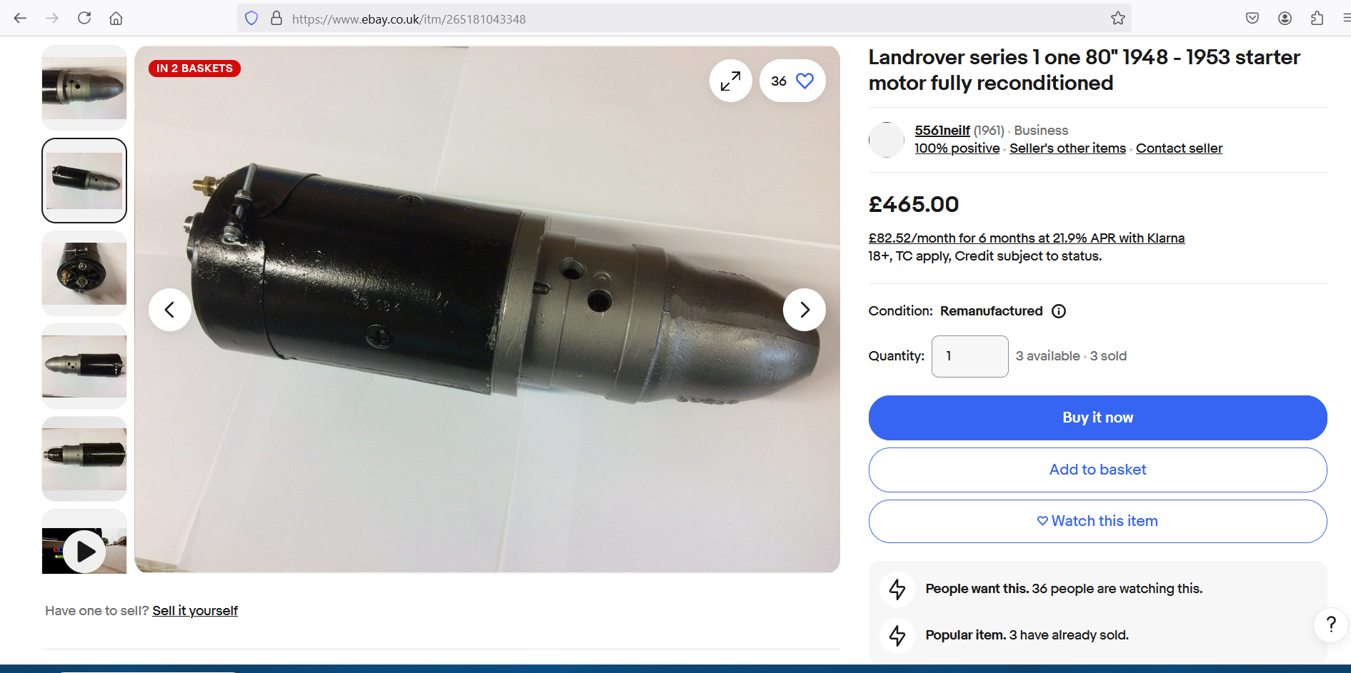

found this one on ebay UK apparently aftermarket.

looks like they are rarer than rocking horse poop.

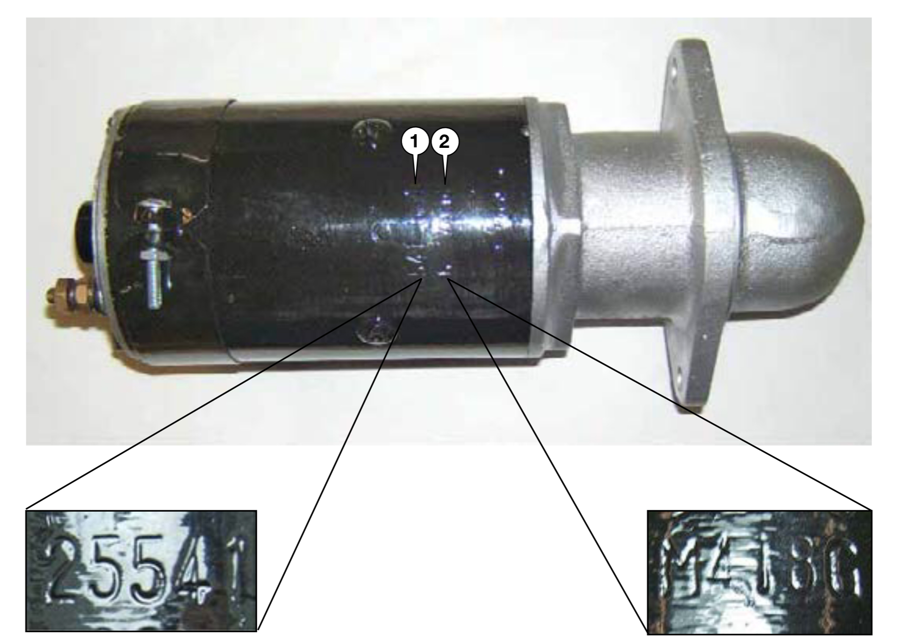

Thanks for info. Do you know the model number of starter on the 1948-54 Petrol and Series 1 and 2 2LT Diesel Land Rovers. Knowing this would be nice. Its stamped on the casing as in attached picture. Its quite possible the M35G starter used the same springs

Literally just spoke with them. They told me this Land Rover used the M45 starter. That said in sure Lucas used many of the same parts for different models of starters. Both the M45 and M418G were made during the same time period, with the latter being a larger starter explaining its use in the Land Rover.

I was able to find new spring that are a close match to the original ones. They are replacement Ford parts. Only two coils (vs the original 3) but same outer diameter, outer "hook" that holds down brush, and inner diameter that attaches to post. Got them from Romaine Electric that has locations in many areas of the US. Went by their shop and was told Ford and Lucas cooperated and they were able to find similar Ford spring. Romaine Part number 69-2701. $1.25 each. Starter is installed and working.

Was also able to confirm that the model of starter in the Triumph TR3 is M418G, not M45 as discussed in some other threads. Many of these starters came is a variety of configurations. These two starters look identical when looking at pictures in service manuals, but the M45 is a much larger motor used in tractors, and apparently some Land Rovers.
