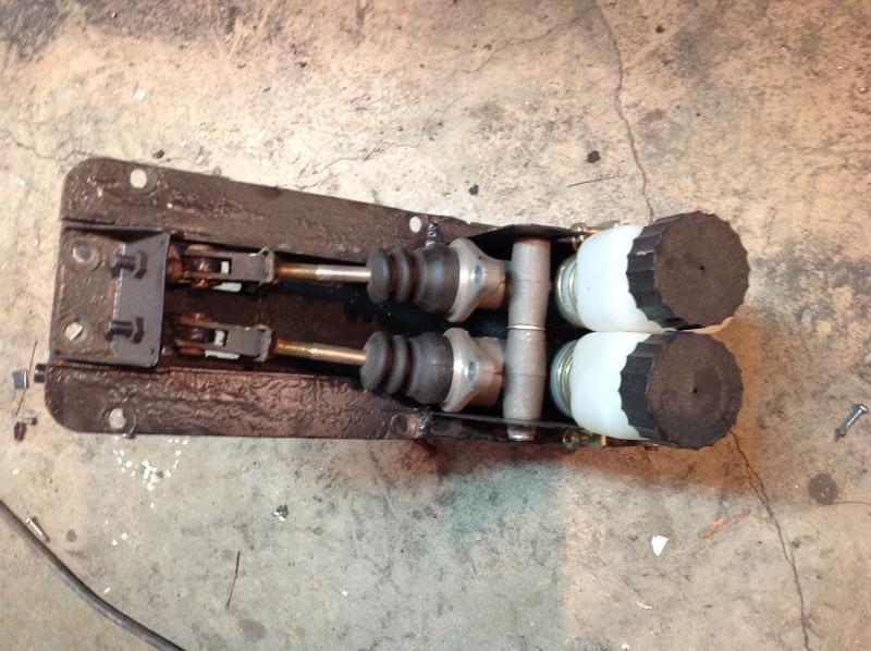

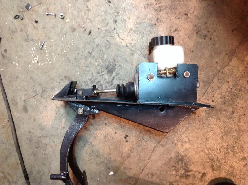

Jim,
There are several ways to address your MCs and I decided to go with a sleeved original from Sierra instead of the one I have pictured. The pictured MC is a pair of Tiltons and they work very well...you can even modify your pedal box for 3 MCs with a bias bar for the brakes as well as a residual valve. You can even go with a Tilton pedal box with any combination of MCs to suit your particular needs.
