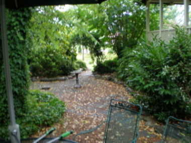

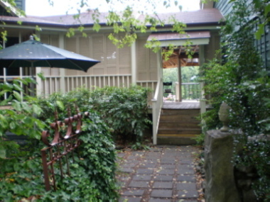

Okay, here's a link to the little courtyard between the house & garage (west side of house; east side of garage) & a view of the dining porch area of the house.....in the summer, the courtyard is always 10-or-so degrees cooler than other parts of the yard & keeps the dining porch comfortable.
...oh, the stone wall that's covered with ivy was used by Confederate forces in a skirmish with the Yankees....seems both armies pulled into the area after dark and made camp - it was a dark, foggy night, not unusual for around here......the next morning when they awoke, they were facing one another & I happen to have the wall the Confederates used for cover in the small skirmish that followed (fence has been redone & shortened in length & some of the walls on other properties completely removed)! As I understand, both forces withdrew from the field of battle when night again fell.
