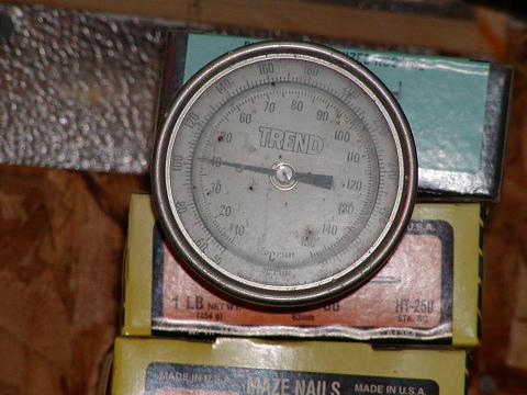

Just installed the screens today. Covering is a garbage bag at the moment. Thanks to Nutmeg for the idea.
Discharge temp. Outside temp 56 F.

Lee - congrats on the project. How 'bout some pictures of the project itself?
I notice your output temp is good - over 100F. What's the "differential" - difference between output temp and temp at the cool air input? Outside temp isn't all that important; it's the "heat rise" (and the amount of air moving through it) that counts.

Nutmeg-0800 43/97 F 1100 56/100 f differential temp No way to check flow as yet. Wind blowing up a gale outside and buffeting the plastic garbage bag. Makes the check flap look like it is breathing.

Lee - looks GREAT! Bravo.
Just to make sure I'm reading you right ...
<div class="ubbcode-block"><div class="ubbcode-header">Quote:]
[/QUOTE]
This means at 8am the cool air inside the room at the bottom vent is 43; the warm air output into the room at the top vent is 97.
And at 11am those numbers become 56 cool air inside at bottom is 56, and warm air output at top vent is 100.
Right?
If so, you are going for the gold!
And thanks for the picture. Looks *very* familiar.
Tom
Edit: so the 8am differential (heat rise) is 97-43=54 degrees, and the 11am differential is 100-56 = 44 degrees?
