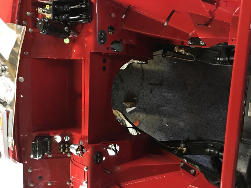

Restoration is not wire ready. I’ve ordered a panel kit from Moss. First next step is buffing exterior which can make a mess so want that done prior to carpet and interior panels. Plus debating on carpet or wiring harness being first.

I would do the wiring first as some goes under the carpet. Looking at a TR4 a friend has I noticed pieces of plastic tube over the "T" shaped wire straps that are welded to the body. I can see that would prevent possible chafing of the wires.

tubes over straps is good. I use Wire shrinks.
you are correct on wiring first
