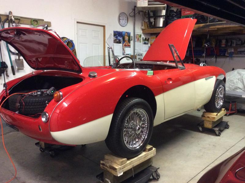

This is the paint that was used to do my 64. Is it correct , is it concour proper .....who knows and to be honest I really don't give a flying frog fart :highly_amused::highly_amused::eagerness:..It looks good to me .
