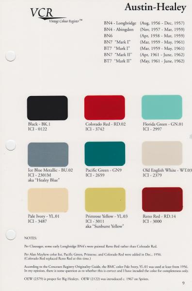

The chip for Colorado Red in the Pikovnic book is nowhere near that orange. My BJ8 was originally CR, but it's been repainted a couple times; a paint shop matched the current color with GM 'Peking Red,' which looks pretty close to CR but, possibly, slightly 'oranger.'
I missed it when this thread came back to life. The body panels are still waiting for paint, so the topic remains important. What is the "Pikovnic book?" Any chance of seeing a photo of that color chip?
Normally, I would not spend this much time looking for color information before painting a car, but I want to get this close to right.
Many of the Healey racers, back in the day when these cars were new, came in the Colorado Red color. Someone on this forum posted pictures or videos of those cars racing in Europe. I was struck by how orange the paint color looked. But I'm still not comfortable with the Colorado Orange that the local paint supplier here came up with. Any other thoughts or help will be much appreciated.

The 'Pikovnik' book is a compilation of color slides listing the available colors for Healeys by model, done by Donald Pikovnik. Here is the slide which includes BN4s:
Are Healeyphiles dedicated, or what?
Carroll, Thanks for your offer of help. I look forward to hearing back from you on this. I have spent hours and hours on trying get color mix information that I can have confidence in. My local paint supply store seems to think that they got it right with the paint used on the inner body and underside, but I'm not convinced.
You are right that the lighting makes a difference. Those pics are taken under fluorescent light; natural daylight does take away a bit of the orange color. Both the BN4 and the BJ7 that I am working are the same color, so it becomes even more important to try to get this right. I have also heard that the Colorado Red color changed a bit over the years that Healey used that color.

Thanks, Bob, for the Healey dedication. That Colorado Red does look more red than I expected. And the Reno Red looks even darker.
