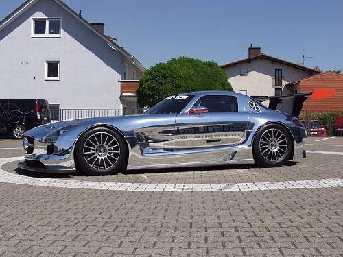

Well it's time to get ready paint and after much deliberation I'm think of going with a chrome finish like pictured below. Has anybody, or do you know anybody, who has attempted this? I'm going to start off with some test piece in the next few week and was looking for any do's and don'ts.

IS this using the process from Jay Leno's Page?
I'm trying out MirraChrome by Alsa Corporation. They says its produces a mirror chrome shine that can be done with a simple spray gun. No process required. I'm going to paint some old fender and see how it works. It can be tinted to give an anodized look as well.
Well...I would say your prep work would have to be beyond beyond perfect to get away with that. Even black is difficult to get right. Charlie
I agree prep work will be an issue, but seeing the square footage is minimal, and it's a Bugeye and not a Merc, I'm figuring a few buddies, beers, bondo, and boards and it might be doable. As for durability yeah I'm researching that with some tuner guys, they love this stuff! I'm still on the fence but will try some test pieces at the shop. I also hear a little goes a long ways so the price may be deceiving based on the coverage I get.

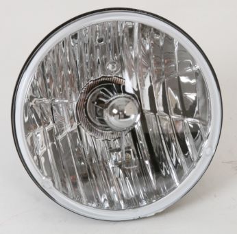

Has anyone tried these Halogen replacement headlights from MOSS?

Branson said:
what happened to the halo headlights you were running? no good?
I picked up a stone and crack one and now I can find another one to match. Seems like they discontinued these, figures. Anyways I looking for alternatives and was wondering if the one from moss were any good. The H-4 I have are great but ones is now cracked!
