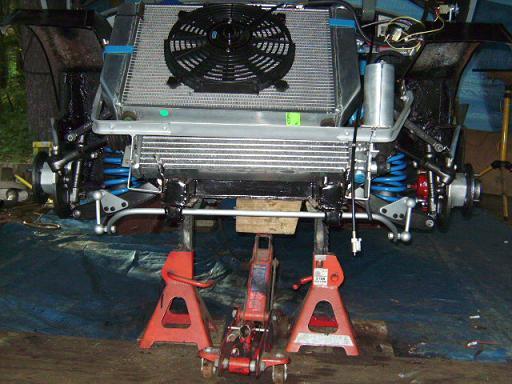

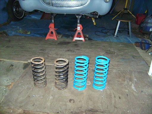

I finally got the Front Disc set-up I needed and it was not easy to find one in rebuildible shape. I figured since I'm in this deep I should change the springs. Does any have any suggestion of what spring would be good for this Bugeye with the rotary installed. I see there are comp springs available and a few different type of stock springs? Any help is greatly appreciated. v/r Dave

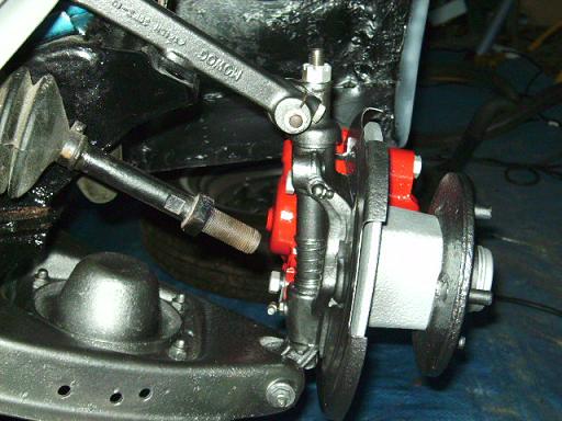

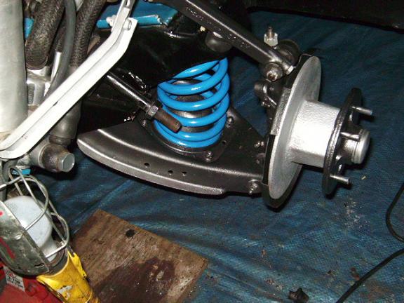

Well I just finished installing the A-arm and disc assemble and something looks funky. The disc/hub is at about a 5 to 10* angle. The old drum set-up was perfectly vertical. Also the disc hub flange face is now a inch or so out farther than the drum face. Does this sound OK, it would seem the the tire will now stick out a bit? Any HELP would be welcome. Thanks Dave.

These are 1275 springs from Moss and they are taller but the coil diameter is smaller. Seem to have a more progressive spring rate the the short stockers. I used these to help with the added weight of the motor and tranny. The original springs were leaving rub marks in the fender well and that was before the motor swap! I hoping it don't pogo!!!!!!!!!!!

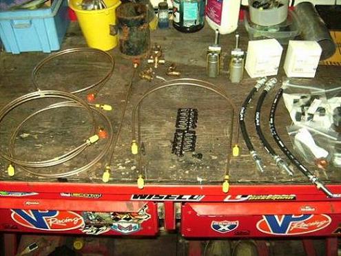

OK I'm getting ready to install new brake lines and fitting, but forgot how the original lines were run and would like to route them close to stock since there pre-made lines. I remember the 4 way block was on the right side, not sure where. Also I can the new hose to the calipers be mounted to the original drum hose bracket?
