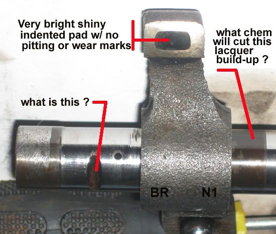

A very interesting project, I am having fun. There are tiny oil paths all in and
out of the assembly. cool! I noticed one odd thing. Every rocker arm except No 12
has a shallow oil path cut from the oil feed hole to the vertical notch cut into
the shaft. Could this account for the problem with No.12 or is there not supposed
to be an oil path for No. 12 ? Photo attached: Thanks all! Paul- I'll drill out
the end plugs when my new shaft arrives.
Dale,
If the shaft was manufactured without the flat oil passage, then #12 would not have oiled as designed and probably what caused the problem. Or, #12 was so worn, the flat just got ground away.
