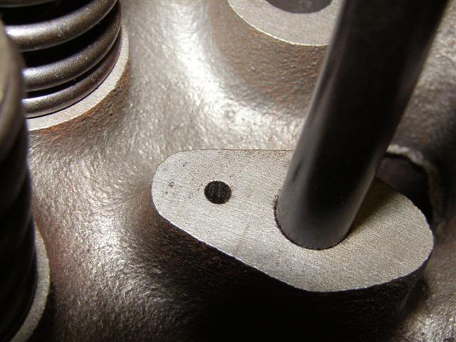

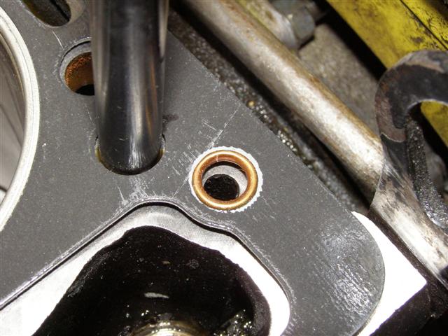

When I did the first head swap on my TR6, despite all of the care and oil changes every 3,000 miles, there was still some build up in and around the block area where that passage that Randall and Ray describe is being fed from. I have added two pics that will show the exposed hole in the block as well as the hole on the cleaned head.
When my head was cooked and cleaned, all of the plugs were removed and the passages were cleaned at that time. The same went for the head as well as the block when I did the total rebuild last spring.
