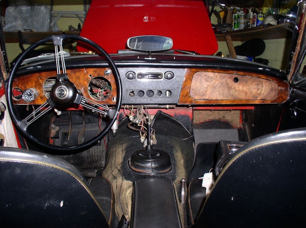

Just added the above photos as info and progress (custom socket with hose clamp, interior progress).
Thanks again!
Paul

Thank you! As of yesterday, dash is completely out now and plan on removing the old coating from the glove box surround for today. Then the driver side and then experimenting with possible staining and clear finishes.
Finally getting to do other long awaited details like refurbishing the hood latch, air ducts, securing the antenna, painting/detailing and other stuff which were concealed from view behind the dash.
I wish I could do a rotisserie job, but as an-place piece meal restoration, I can't complain.

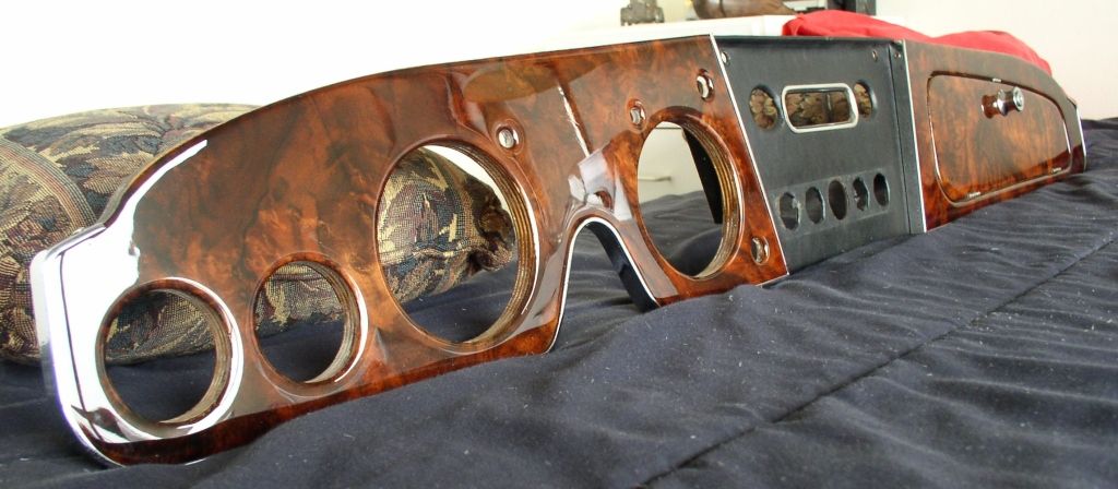

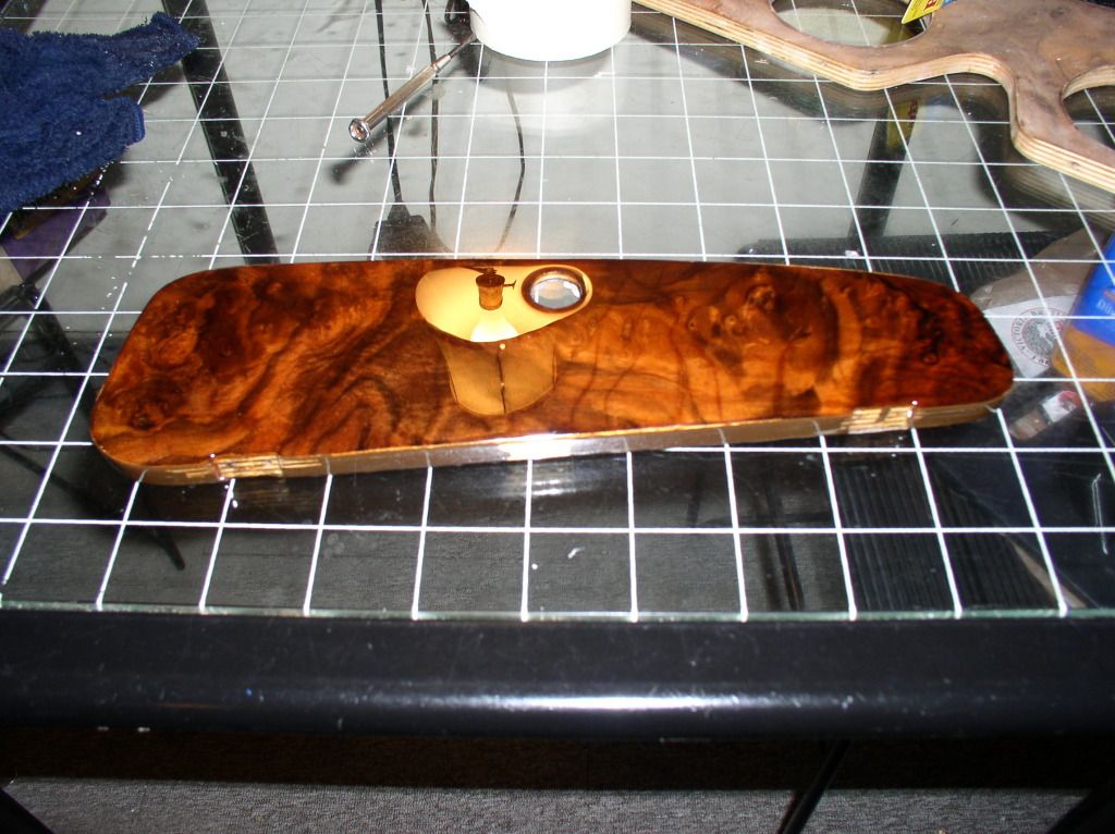

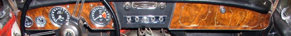

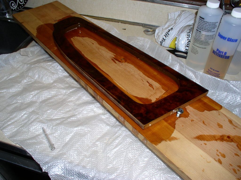

Just wanted to share my results...
Some progress shots of my salvaged wood veneer dash, before and almost after. For the past week or so, I've been experimenting with the application of brush on polyurethane, lacquer sprays and epoxy resin. Those who recommended other products were not available or found in local hardware stores by me. So, I went with what was readily available. Also experimented with scratch fillers and staining. The scratch filler was beneficial but the staining proved not necessary so I did not use.
As for the coating techniques, I was not happy with the results of polyurethane and lacquer from the mock-ups I made. But the epoxy resin left a nice finish or one I can definitely live with. Overall not bad with exception of a few small blemishes here and there but I will invest in a decent buffer and use to polish out later on.
The biggest challenge in all this, using the epoxy resin anyway, was to keep the veneer pieces perfectly flat (ends has a slight curl), leveled and propped up to allow excess epoxy to flow over. So, the preparation was the hardest part. The pouring, with exception of ridding the tiny air bubbles as it was curing, was relativily the easiest.
It looks absolutely great to me, exhibiting a super high gloss, wet finish. But here again, as in my using 78 record dust for the steering wheel, time will tell if this will hold up in the long run against the elements. UV rays and extreme heat (above 120 degrees) are my primary concern for the longevity of the epoxy coating.
I understand there are UV inhibitors out there. Maybe I can simply apply a protective wax instead. I'd be curious to know if anyone else has used epoxies and what there feelings are in general.
Paul

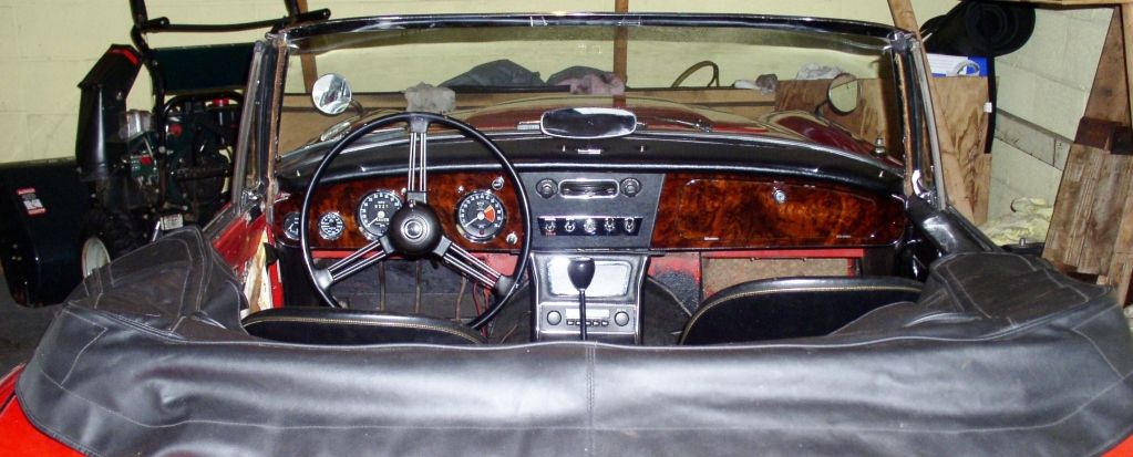

Finally, the wood portion of the dash is back and so far, I cannot take a picture good enough to show just how nice this epoxy resin job turned out for me. I still have minor imperfections to correct but I really have to look hard to notice, even in the daylight.
The only issues resulting from taking the gauges out, etc. is, I need to recalibrate (or reposition) the oil gauge so it reads at the zero mark when the engine is off. Instead, it now reads at 20 lbs. at rest or before starting. If anyone knows the proper step, please let me know.
